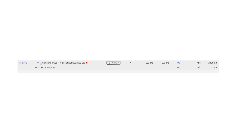

I do have a NTFS formatted USB-SSD. Whenever I plug that disk into my server, Unraid tells me this disk is part of the Array. But it is not and it never was. It's not possible to mount that disk.
The only options I do have currently is to a.) Remove the partition or b.) Clear the disk c.) Change the label.
I would like to mount and use that SSD without removing lines from files in /boot/config.
Is there a way to tell the GUI to ignore that Array flag - wherever it comes from - and mount and use that disk without rebooting the server?
Thanks in advance.
That is from the UD plugin, but try rebooting first, if the same post the diagnostics.
Reboot is the last step I would do for a 24/7 server. Is there no way to tell Unraid/UD "You are wrong, this is not an Array Device, mount that device" ?
EDIT: Seems that this is not possible. Had another USB Device in the past. That told me "Reboot" but who wants to reboot a server just to get a USB Backup Device up and running again. Did Clear that disk and did create a new Backup on that Disk. Will do that again now. IMHO there are some options missing in the UI to overrule some false assumptions.
