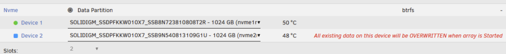

Performed as requested. Created new pool with same name, added the OTHER nvme to the one earlier, started in maint modeimage.pngIt's added the second device itself (i assume that's it reading the btrfs config?), and getting warnings for pool missing device.
Checking /mnt/nvme still shows nothing (other than empty system and domain dirs).

The missing device is normal; the pool was imported degraded, but post new diags after starting in normal mode, maintenance mode doesn't mount any filesystem.
