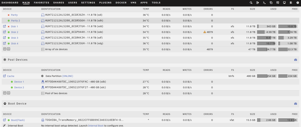

Before changing anything, please attach Tools → Diagnostics and a screenshot of Main. A red mark means disabled; it does not by itself prove that the drive has physically failed. Please also confirm whether the earlier moves completed without errors and whether you have an independent backup.
For now, avoid New Config, parity rebuilds, and rebalancing. The priority is to copy the remaining files, retain the originals, and verify the copies.

Here's the pic and diags you requested.
Thank you very much indeed for your input.

In addition to parity and disk1, disk2 does also appear to be failing. Its SMART report warns of impending failure, records a lot of uncorrected read errors, and shows two failed short self-tests. I would prioritize copying the remaining wanted files rather than running more tests.
Stop the array and shut down, then replace the disabled P1 disk physically with one of the 10 TB disks. Leave the new disk unassigned, with the other array assignments unchanged. Prepare only that new blank disk through Unassigned Devices, preferably as XFS, then restart the existing array and copy the wanted files from disk2 to it.
Use copy rather than move, keeping the originals for now. If some files produce read errors, record which ones failed and continue with the readable files. With P1 and D1 already disabled, parity cannot reliably recover unreadable sectors on D2.
One other detail: the diagnostics show about 878 GiB still used on emulated disk1. Please check whether that contains anything you still need, or whether everything there already has a good copy elsewhere.
For now, avoid New Config, parity checks/rebuilds, and rebalancing. Once the wanted files are safe, we can arrange the final configuration and build parity once. Do not add the populated transfer disk through the normal add-disk procedure, because that would clear it.

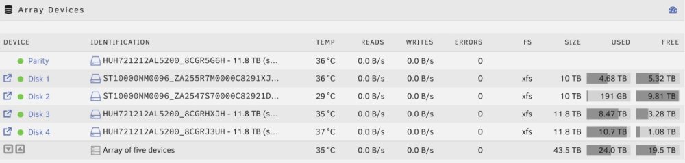

Hi guys,
Soooo, all good so far (he says very tentatively!)
Disks are in as we agreed, parity is rebuilding (usually about 17h). I've checked a pile of files and Got a question on this step:
--Assign new 10TB when doing New Config, then format it after starting the array. You can do the format during or after parity build
The new 10TB disk is in (assigned to D2), and as expected is showing as unformatted. How do I format it now during the parity build as suggested?
Cheers!
Click the "format" button, next to array start/stop, make sure it's the only disk listed as the one to be formatted.
omg, so sorry, I was looking in the disk settings. Got it, and done.
The array is fully back online, parity complete, lights are green, 5-5-5.
Thank you both so so much!
