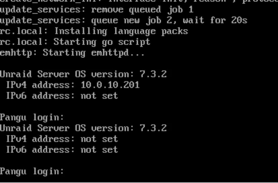

TL;DR: Unraid drops IP address but webUI is accessible. Containers in Bridge mode not connecting, apps page not loading.
Unraid drops the IP address a few minutes after boot, with or without the array started (see screenshot). *While accessing the web UI*, it displays the alert “Interface - Ethernet Port 1 is down. Check cable!”, and Plex (host connection) is working as normal. So obviously the ethernet port is not down.

I would hold off on the factory reset for now. Your diagnostics show an actual Ethernet link interruption. At 06:19:22, br0 loses carrier and its default route. DHCP restores the address at 06:20:06. The link is up when the diagnostics finish, so being able to open the WebGUI does not rule out that earlier interruption.
Both boot logs show the drop immediately before Tips and Tweaks reports applying its settings. Could you try a boot in Safe Mode and see whether the warning returns? Use local access for this test, because Safe Mode also disables the Tailscale plugin. Keep Gluetun and any applications that depend on its VPN stopped during the test.

Thank you for all this detail. I am accessing over LAN and the actual ethernet interruption was almost certainly me moving cables.
Other than general frustration with this issue, the main factors prompting a factory reset were that my Docker containers couldn't be edited and I wanted to clean out older unused or deleted container data and templates, but those were easy fixes.
Things seemed stable after this and rebooting the network equipment. I still see "not set" for the IP addresses in the console (screenshot in OP), but functionally, everything seems to be working as expected. As of now, I do not have Gluetun or qBittorrent installed or running.

The network looks healthy at the time of these diagnostics: br0 has its LAN address, and the Ethernet link is up at 10 Gb/s.
The IPv4 “not set” message likely appeared before Unraid received its DHCP address during boot. The diagnostics confirm that it subsequently obtained an address and that the LAN connection is working.
There was a brief startup link interruption, but no further drops appear during the following 16 hours. I would not recommend a factory reset based on this.
Back up the working configuration, then reinstall Gluetun using Bridge networking. Confirm that the VPN, LAN access, and Apps work before adding qBittorrent. If connectivity fails again, collect fresh diagnostics before rebooting.
