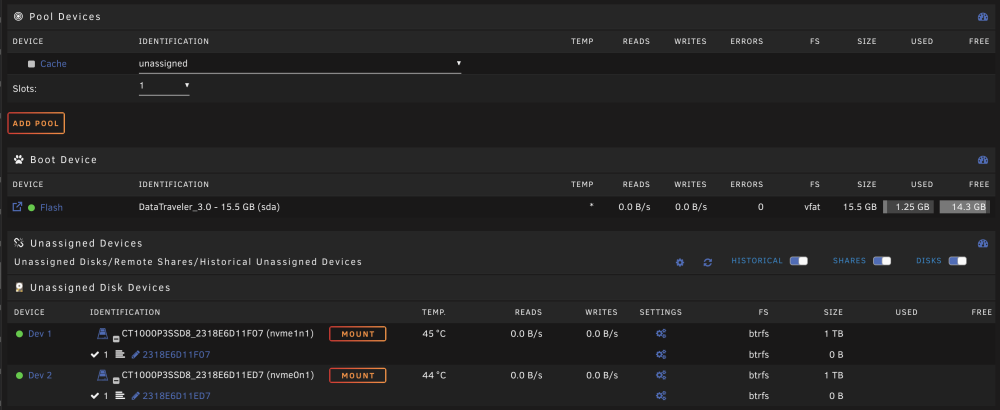

Hello,
To give some context, i'm not at home at the moment and I've been facing what might be a power outage on my unraid server. I did log back few hours ago, start a parity check because it was not a healthy shutdown. Then the server became unresponsive few hours later but in fact I was able to see it was connected to the network, usually i'm loogin through ip:8888 but it's now just ip and the name change from its name to Tower (like default name) and the two NVME usually mount as cache are appearing as unmount in the interface. I don't know what to do ?
Any suggestion I'm a bit worried, I ask AI of course and it says it could be an issue with the flash drive.
But I prefer to ask experienced users of course before taking any action.
The server name reverting to 'Tower' definitely indicates that Unraid had problems reading the name you defined for the server from the flash drive.
You are likely to get more informed feedback if you attach your system's diagnostics zip file to your next post in this thread.
It is always a good idea to do this to allow us to see the current state of your system and so we can see logs and configuration information.
The diagnostics point to lost or damaged configuration on the USB flash drive. There are recovered-file artifacts on the flash, the server settings contain Tower and port 80, and the cache pool has no assigned devices.
Both Crucial NVMe drives are still detected as members of the same Btrfs filesystem. Neither reports media-integrity errors. This is encouraging, although it does not yet confirm that the pool can mount or that all its data is intact.
For now, please leave the array stopped. Do not format either SSD, run New Config, or run filesystem repair commands.
Save a current flash backup through Main → Flash → Flash Backup, and keep any older backup separately. Do you have a flash backup from before this happened?
For the pool, reimporting should work:
on main click on the first device for that pool and then "remove pool"
back on main, create a new pool with the same name and number of slots
assign the pool devices, leave the filesystem set to auto
start the array to import the pool
Since you are away, avoid rebooting or removing the flash until someone can assist locally.
