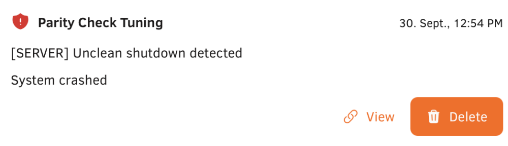

5. Couple Years ago, like in the 6.X era these things almost never happened, I'd go as far as to say these only started to happen in the 7.2/3 era. But like this? It's the first time. Like the system got stuck a couple of times over the years and needed a full hard reboot but that was mostly because I was dumb. A complete system crash, like this, never happened. Why do I know this? Because this message: image.pngHas never appeared before. This is the first time. Before you ask: Parity Check Tuning is installed but it hasn't been turned on nor is it running scheduled Checks.
