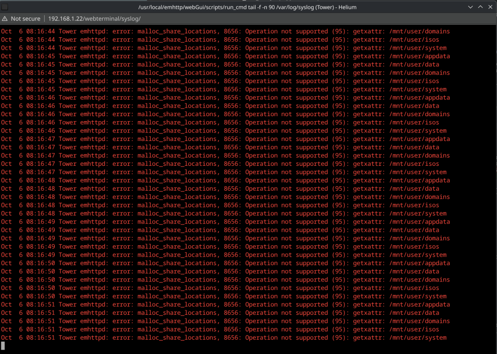

I see a ton of error about all my shares in the syslog window

This isn't related to parity, there' soemhting creating /mnt/user/appdata before the array is tsrated
Oct 5 20:01:09 Tower emhttpd: error: malloc_share_locations, 8656: Operation not supported (95): getxattr: /mnt/user/appdata
This cannot happen. Start by rebooting in safe mode to rule out a plugin or your modified go file, if it still happens, post new diags from safe mode.
