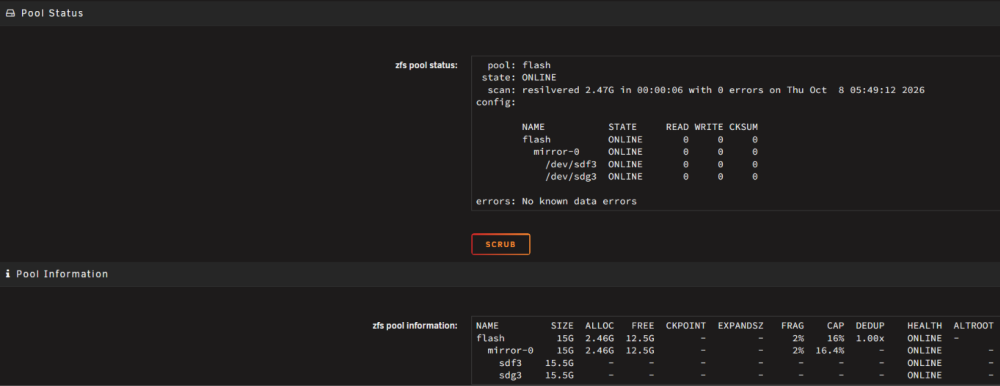

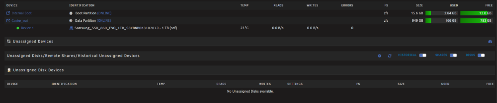

I followed your steps, but it still hangs, I believe. I rebooted to set the pool back to 1, but when I rebooted again, it was already on one slot, and now the other drive (Samsung_SSD_860_EVO_1TB_S4BDNS0N804536P) is not showing under Unassigned Devices. I've also included screenshots from after the reboot if that helps.

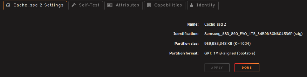

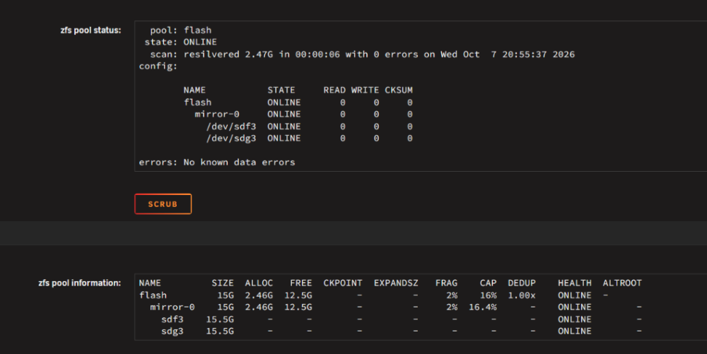

Sorry for the late reply. Thank you for looking into this. I tried again this time in safe mode as you suggested. I'm not sure what I should have been looking for, but I took some screenshots of the drives after doing it again in safe mode, in case they are of any use. I probably should have taken the diagnostic, but I wasn't sure if you needed it. For the U-Manager plugin, I did uninstall the U-Manager Companion plugin prior to doing the instructions because I thought that might have something to do with it, as I had a problem with it before.

Those screenshots look good, but they are for the flash fool, not the data pool, which is the one being the problem. Please post new diags.
Here's the most recent diagnostic.
Regarding the flash pool, yeah, I should have also said that even though it does create the mirror for the other drive in the flash pool, it doesn't mount or show the data pool when I put the second drive into slot 2.
