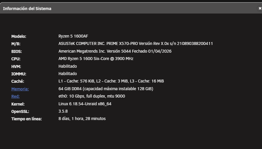

One of my servers has been on this version for 8 days now and it's working well. 😊
It hasn't had any problems.
