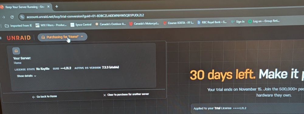

not looking online at my account, I see "license state: NO KEYFILE"
ive activated my trial, but the code it gives me is the same one as listed that says NO KEY FILE.

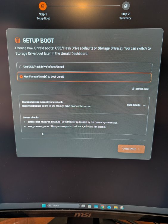

Do you mean you configured it for internal boot? You still need the flash drive for trial license.
I did set it up for internal boot originally. I've been using the flash drive since I re downloader the OS onto it

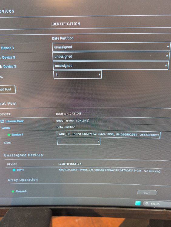

I think I figured it out. Not sure how to fix it, but figured it out. Somehow, my flash drive is listed as an array drive, and the internal SSD is listed as boot drive. However, the system was booting off the flash drive, which was then being shut down because my license key issue. I'm simply booting from the SSD now, and it works. However, I suspect my flash drive is actually where the key is stored, not the SSD.PXL_20261017_185940996.jpg
Got it! I was right, there was no key file in the SSD, just in the USB drive. But I couldn't boot off the USB drive because I didn't have a key. So I finally figured out I could access the boot drive files, made a copy of the key and then uploaded the key file into the config folder. Everything works now!!!
That is correct, the license can only be tied to a flash drive or TPM 2.0 device, not an internal boot pool.
