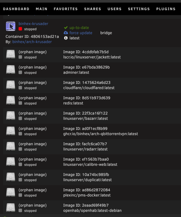

Docker orphaned images during update 7.2.4 -> 7.3.4
I've been trying to update to 7.3.4 from 7.2.4 last night, but after the update, half of my docker containers were deleted, resulting with orphaned images. I had to revert back to 7.2.4 for the time being. Is there a way to prevent this behaviour ?

This doesn't appear to have been caused by the update itself, but by the RAM-DISK-Dockerlog plugin. Your appdata and container templates should be fine, so everything can be recovered.
The plugin keeps Docker's container information on a RAM disk and keeps a copy in appdata/containers_backup. On 7.3.4 Docker loaded an old copy of that information. That is why some current containers are missing (their images now show as orphaned), the old entries fail with "RWLayer ... is unexpectedly nil", and older containers like overseerr and paperless-ng came back. Another user had the same problem on 7.3.4 with the latest plugin version (2026.10.09a), so updating the plugin is not enough. For now I recommend removing it.

Yes I had seen your previous answer. So I tried the following procedure :
1) Downgrade to 7.2.4. All containers are present and working.
2) Remove the RAM-DISK-Dockerlog plugin.
3) Remove the ram disk section added in /boot/config/go~ and reboot.
4) Delete the folder /mnt/cache/appdata/containers_backup.
5) Update to 7.3.4.
But unfortunately, containers are still missing...
monalisa-diagnostics-20261023-1417.zip

Following my investigations, something is weird : the missing containers are not the same between each reboot in 7.3.4. Sometimes Plex starts, the next reboot it is an orphaned image.
The plugin is gone now, but it left old container entries inside the Docker vDisk itself. Deleting containers_backup does not remove those. 7.2.4 hides them, which is why everything looks fine there. On 7.3.4 they are loaded again, so old versions of some containers (for example overseerr and paperless-ng) come back. Because they use the same names as the current containers, which ones show up can change after each reboot.

So it did the trick. I removed the old entries (I had to do it multiple times..) and added back four missing containers, after a reboot some other container went missing. Each reboot presented new faulty containers... I followed your procedure as long as orphan images appeared, it seems okay now! Thank you for your help.
