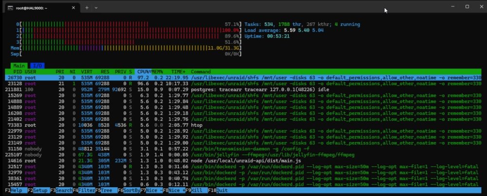

After Update to 7.3.3/7.3.4 I have shfs processes gone wild
The diagnostics show the shfs process for /mnt/user using about two CPU cores the whole time since boot, with high system CPU. That is not normal, and I would like to see what it is doing. With the problem present, open a terminal and run:
Oh, you speak magic? ;)
Then post the shfs-debug.txt file from your flash drive.
done
The other tests I will run next morning. Backing up /mnt/cache as we speak.
Thanks a lot for your help in advance.
shfs-debug.txt
Thanks, that helps. Only a few file locks are held, so shfs is not stuck on locks. Two shfs threads are reading continuously from a file on the cache pool, and most of the CPU time is the kernel checking Btrfs checksums for those reads. So shfs is passing on a heavy, nonstop read load, most likely from the docker image or appdata.
