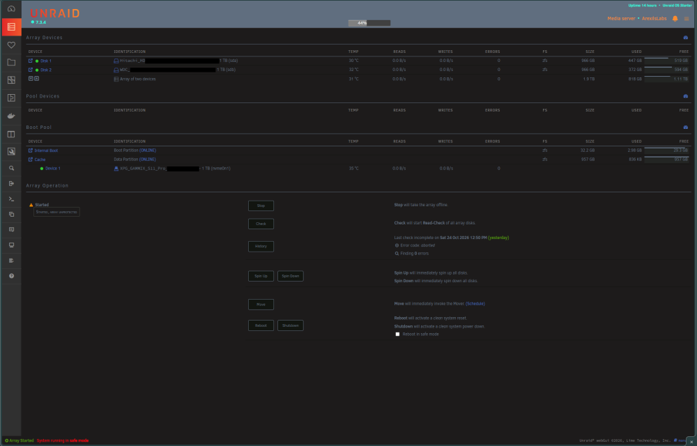

    • Checked the main page: the array is started successfully, and the "Reboot in safe mode" checkbox is completely unchecked.
    • Attempted multiple normal reboots, but it bypasses the setting and goes straight back into Safe Mode.

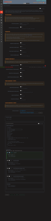

Also go to Settings - Boot Parameters and check safe mode is not enabled there.
Yes, I attached a screenshot to the message, and it's posted there.

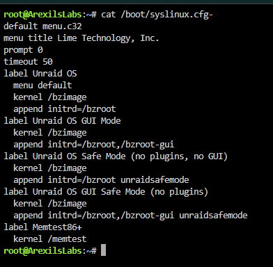

What do you get from command line with this?
cat /boot/syslinux.cfg-
That seems to say default boot is no GUI

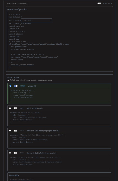

Thanks. Since you boot from the internal NVMe, the server uses GRUB and not syslinux, so the syslinux.cfg- file in /boot is not used. Your boot log shows the server is starting the "Unraid OS GUI Safe Mode (no plugins)" boot menu entry. Please post the output of:
cat /boot/grub/grub.cfg
Paste it as text, not a screenshot.

Thanks, that grub.cfg is the default one and it is set to boot "Unraid OS" (normal mode, no safe mode) after the 5 second countdown. Nothing else in Unraid changes the boot entry, so with this config the server should only boot into safe mode if the "Unraid OS GUI Safe Mode (no plugins)" entry is selected in the boot menu.
Please connect a monitor and keyboard, reboot, and watch the boot menu:
- Which entry is highlighted when the menu first appears?
- Does the countdown run and boot by itself, or does it stop?
Then use the arrow keys to select "Unraid OS" (or "Unraid OS GUI Mode" if you want the local GUI) and press Enter. Plugins and the Apps tab should load on that boot. After that, reboot once more without touching anything and let us know which mode it boots into.
Also, if there is any KVM switch, IP KVM or other remote console device connected to the server, please mention it.
