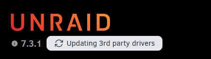

I tried updating 7.3.1->7.3.4 and it seems like the update got stuck on updating 3rd party drivers. Has been like this for around 2 hours with no safe to restart notification.

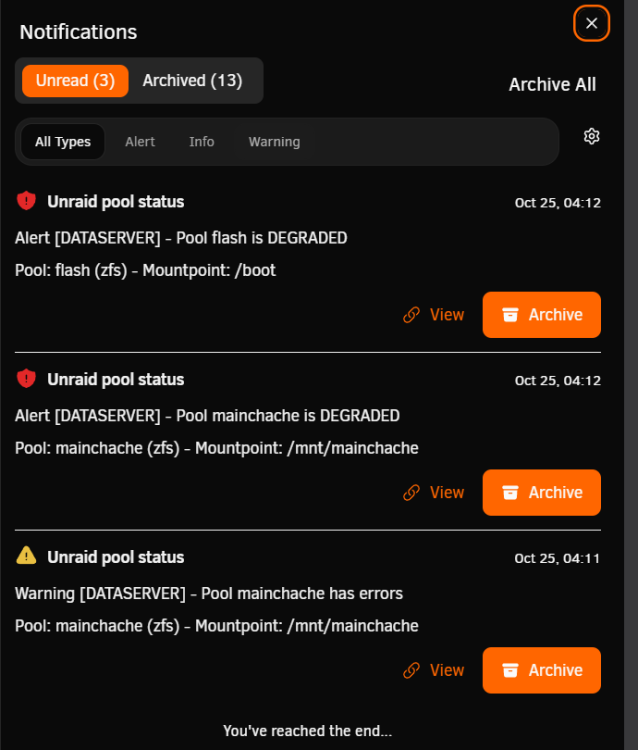

I got an email notification from the server:

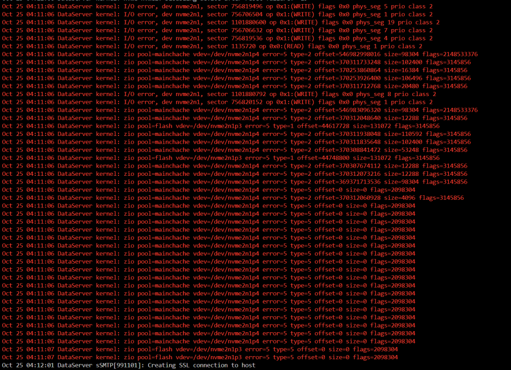

Terminated                 inotifywait -q /boot/changes.txt -e move_self,delete_self,modify > /dev/null 2>&1
Attached diagnostics. While building diagnostics I got:
Diagnostics build was stuck for a while on ZFS master plugin.
Anything I should do prior to reboot? Is my 2nd nvme drive dead and is the cause of this?
