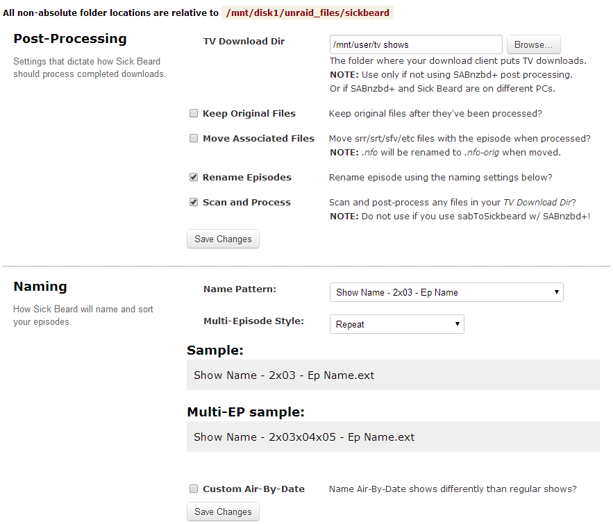

I have updated to the latest and I am still missing all my tv shows and sickbeard still fails to move files
2014-04-01 20:01:50 POSTPROCESSER :: Unable to move file /mnt/user/tv shows/Firefly/Firefly - 1x04 - Jaynestown.mkv to /mnt/disk2/tv shows/Firefly/Firefly - 1x04 - Jaynestown.mkv: 2
the funny thing is it is now trying to move the files from a share to a drive...

There's something wonky going on with your setup.  Unless you've told SB to use the disk2 share, there's absolutely no reason why it would try to move it there.
Let's look at all the components.  First, what disks do you have included in your tv show users share?  Is there free space?
Next, take a look at the Firefly show page.  My guess is that it's saying the target directory is /mnt/disk2/tv shows/Firefly, but I assume you want it under your tv shows user share?  (If you've ever added a show directly from disk2, SB will likely save that path, and you may have mistakenly made it the default path.  You can test by adding a show under SB, and pay attention to the location section).
This could also be a combined issue with SAB.  Do you have TV sorting turned on?  If using SB, you should not.  If there are times you get TV shows but don't want SB to handle it, I can explain how to keep the built-in SAB tv sorting on, but use a different category for SB.  But for the purposes of figuring out this issue, turn off TV sorting in SAB.

tv download directory is /mnt/user/tv shows
and a screen dump of the share setup is attached
the funny thing is I have been running a script in SAB along, it all just fell over for what appears to be no reason

delete the path that you have in the tv download directory and the checkmark in Scan and Process. If you are using the script in SAB+, you should leave those blank.

How about the Firefly config page?  I'd like to know if the path there is set on disk2.
some how it was, i changed it to the right place now, thanks for the idea!

looks like all of my shows have changed to disk2, instead of manually doing each one, can I change it some where else?

Go to the Manage Tab and select mass update.
In the first column, Edit, put a checkmark and then scroll all the way down and click on Edit Selected.
Now you can edit the root directory for where all the shows should be saved to.
