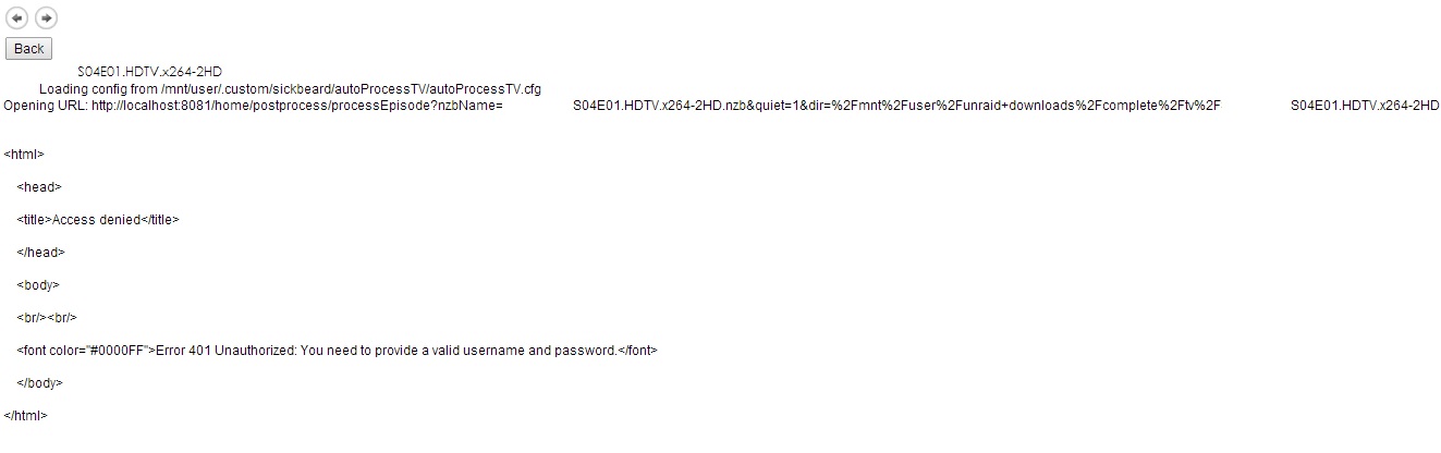

thanks. now I have start to download a file to test but it was not processed at the end of the download. do I need to ave a script running in sab to tell sickbeard it has finished downloading? I have just noticed that all files downloaded are being set to 0666 permissions but the folders are 0777. that does not appear to be normal to me and Sickbeard is not even looking in the downloads folder for files
ok, did a manual process and it worked for show I already had in the download folder. I downloaded another episode to test and I got the attached error in SAB

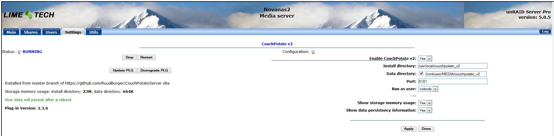

Hello,
I just installed the Couch Potato unplugged plugin and according to the settings page it says it is running. But I cannot access the web page of Couch Potato.
What can it be?

Have you tried a different port? Do all the rest of the apps work?

I tried other ports yes. And I don't have that many apps on my Unraid server. Just Sabnzbd and it works fine.

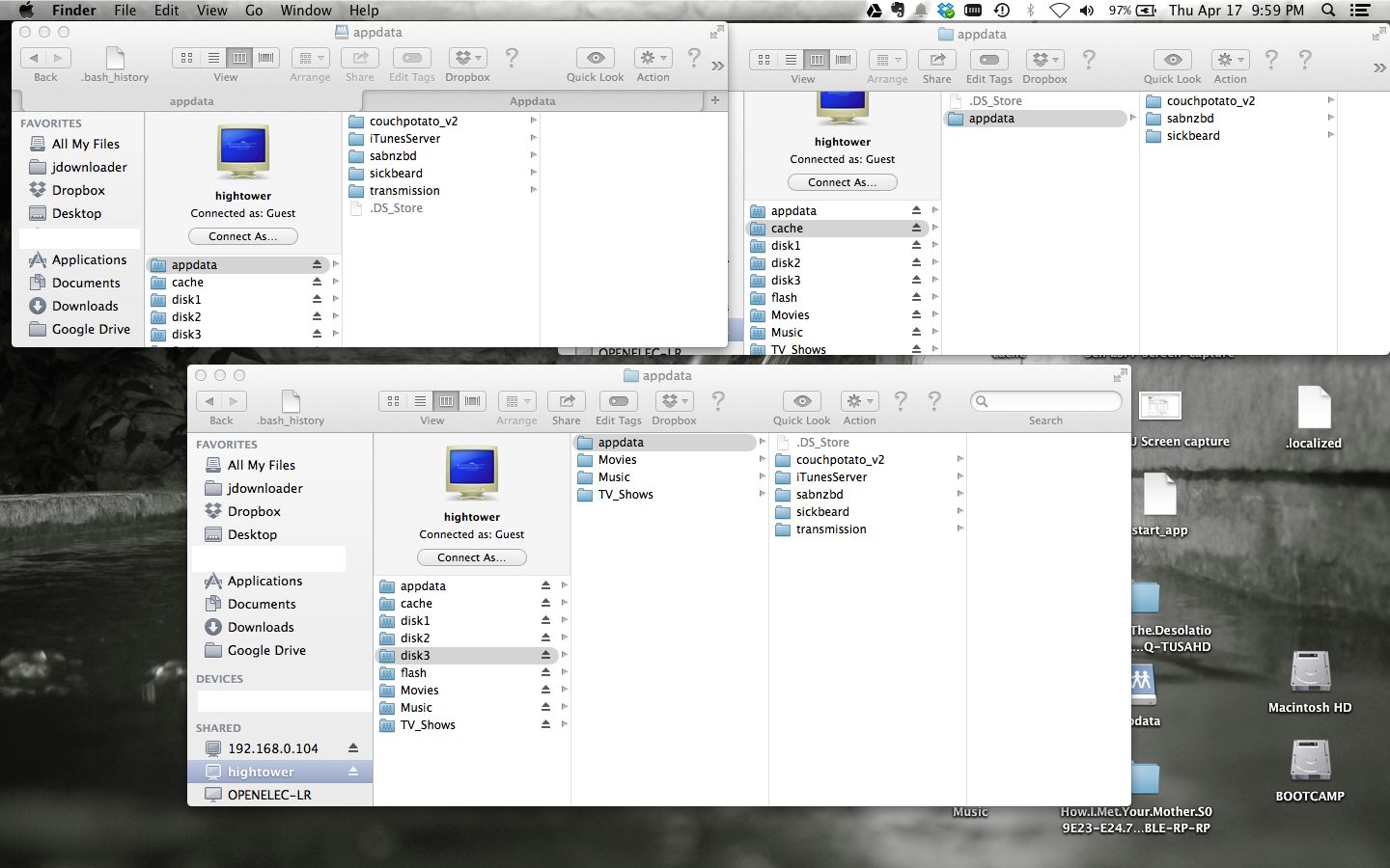

Sadly I think something is broken and now my appdata (and plugins directories) are now located on 2 of my data disks and my cache.  And they don't start because they can't find the plugin files like the SaB directory, etc.  The files do exist but they are on one of the disks.
I want to start from scratch with my appdata share again but what is the best way to proceed?
1) Is there an uninstall plg command?
2) What is the safe way to get rid of the appdata share? Is there a process detailed somewhere on how to do this  ie. disable the share, delete the app data directory from all drives and then create a new share
I was figuring to get all the plugins working again and then upgrade the Unraid OS version to 5.0.5.  Thoughts? suggestions?
I appreciate the help.
I attached a screen shot of what my appdata looks like on the different drives.  I think the cache drive has only 3 apps because I tried to reinstall it from the webGui.
vdsilva,
Delete the appdata folder from all drives. Then if you go to the share settings page, it will say that the share is empty. After it's empty, you can delete the share if you want, but unless you want to have a different share name, just set it to Use cache: Only. This will prevent it from getting moved to other drives. Then setup your apps again.

So I've deleted all the other directories for the other plugins but I cannot delete the transmission directory.  I connect via samba to the appdata share and when I delete the directory I get a warning (Mac OSx) stating that I can't delete the files because I don't have permission.  I am connecting as a guest which is probably the problem.  Can someone suggest another method to try and delete the transmission directory?  I can telnet in but am unsure of the command syntax.
Thanks!
vdsilva,
Thanks!
From telnet just run Midnight Commander:
