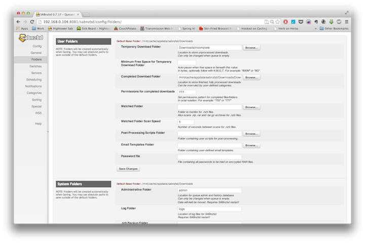

I'm running into a folder rights issue with Sabnzbd+ and I can't seem to find a solution in the thread.
I'm getting Post Process aborted messages because Sab can't create the final folder.  I attached a picture of my Folders config page and i set the permissions to 777 for the completed folder.  I am running Sabnzbd+ as user nobody.
My incomplete folder is set to /Downloads/incomplete
I was troubleshooting this problem so I set the complete folders path to the full path from /mnt/cache/etc..... but it did not work when the path was relative to the default base folder i.e. /Downloads/complete
Thanks.

Should perhaps simplify the structure and specify the path explicitly, such as:
Incomplete folder: /mnt/cache/appdata/sabnzbd/Downloads/Incomplete
Complete folder:  /mnt/cache/appdata/sabnzbd/Downloads/Complete
Don't forget to make "appdata" a cache only share or use ".appdata" instead.  Be sure your queue is empty before changing the incomplete folder path.  Also be mindful when using caps.  "Download" and "download" in Linux are not the same.  Are you using a script for post processing?  Looks like you also need to update some things in the plug-in GUI as the default path is /mnt/cache/appdata/sabnzbd/Downloads".
Thanks I will clean up the paths and worst case make them explicit.  I do not use any post processing scripts either.  How would someone uninstall the plugin if I want to start with a completely fresh install?
