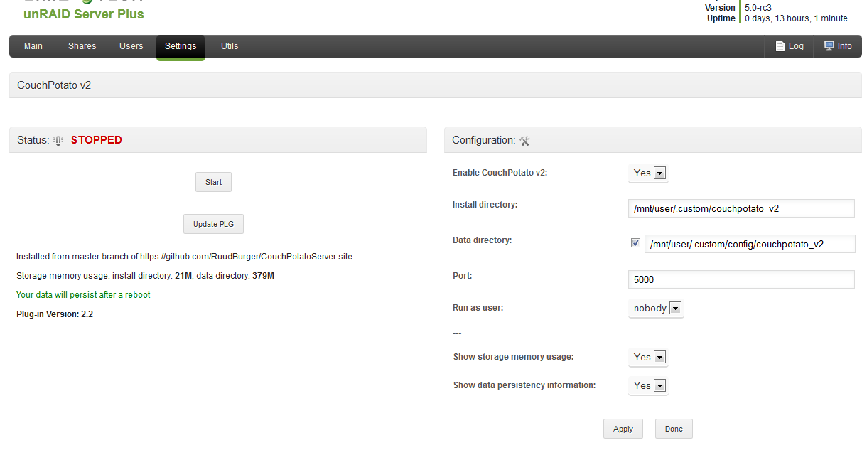

Thanks for all your plugins! They all working great for me except CouchPotato. For some reason it won't autostart after a reboot, I have to manually start it. Sickbeard and SABNZBD both startup fine. They all installed in the same place in their own folder.
See attached screenshot...
As there somewhere I can look to see why it doesn't autostart? All I have are your 3 plugins, snap, ssh, and simpl features installed.

Couchpotato looks like I accidentally overwrote the plugin with partially changed version. I had made the changes and was trying something else out, might have accidentally committed the auto saved "draft". It'll be this afternoon before I can get in to change it.

Fixed the stray ) real quick, but there is still a bug where the pid_file isn't being created so the plug-in doesn't think couchpotato is running when it actually is. I'll look to see if this is a problem with the plugin or with couchpotato tonight. Sorry for the mess!
EDIT: Seems to be working now, I'll still check it out, might be intermittent issue. Also not finding version correctly, I'll look at that also tonight!
EDIT 2: OK, realized what the problem was, the new way of checking the version will only work if you reboot the server. It requires a slightly different method of installing the plug-in so that it can pull the version. If you don't want to restart the server, you can manually delete the installdir (ONLY DO THIS IF YOUR DATA DIR IS DIFFERENT) and re-install. If your data dir is the same, you'll have to manually delete all of the install files, leaving your data files alone!
