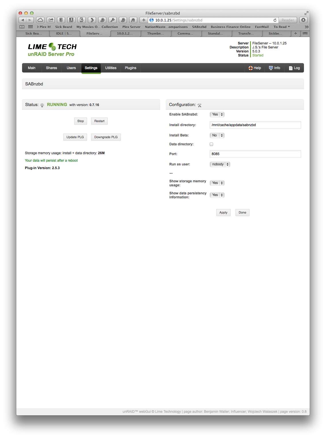

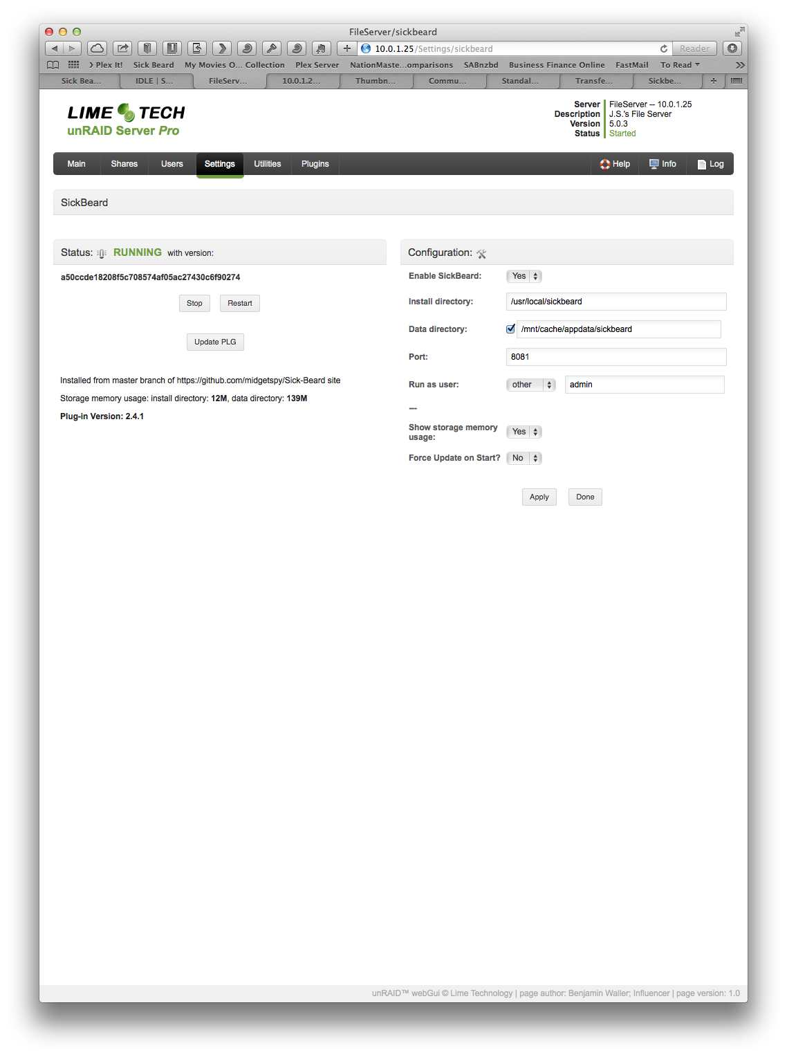

Well, I have good news and bad news ...
You were right, it seems to be specific to the mover script. I changed the share settings for both the "appdata" and the "cachetmp" folder to be use only the cache, but unfortunately, when I manually activated the mover script, it seems to have done whatever leads to the problem. I replaces my config.ini and sick beard.db files with "new install" files and I lose my settings, show listing and SickBeard stops working. and that's the good news ... At least I have a better understanding of what's going on!
The bad news is that I can't seem to figure out why it's happening and how to fix it :(
Any ideas what might be the problem?

Thanks guys! I appreciate your efforts.
Using the period in-front of my directories might be the solution that I settle with, but in the meantime, I've attached screenshots of my settings for both SickBeard and SABnzbd.
It is a Mover script issue. I turned off the Mover and I have not had any other issues. I have also discovered that it is both apps that suffer the problem. It only becomes apparent for SABnzbd after a restart.
I would love to hear what you think of my settings. In fact, I would love your advice :)
I would also try to minimize the spin up of my drives, including the cache drive if I could. I would probably be willing to add a small drive, maybe even a laptop drive to help with that and to be used only for my apps. What do you guys think? Any good guides that describe how to set that up?
Thanks again for all you help ... This is a great community!
ok berg, so looking at your screenshots i would configure as follows:-
sabnzbd
install directory set to /mnt/cache/appdata/sabnzbd
tick data directory and set to /mnt/cache/appdata/sabnzbd/data
sickbeard
install directory set to  /mnt/cache/appdata/sickbeard
tick data directory and set to /mnt/cache/appdata/sickbeard/data
basically as you have it set right now your not specifying a data directory for sabnzbd, and for sickbeard your installing to ram, so everything will be lost on a reboot!! (/usr/local is stored in ram)
one other thing to note, i would advise setting the "run as user" to be "nobody", unless there is a particular reason you wish to tie the permissions down to a single account? (admin in your case)
sabnzbd
sickbeard
I must have missed this step.  Both of my directory settings are the same, meaning I did not create a data directory.  The instructions said to check the box and put the same path in there.  Therefore all 3 use the same install and data directory.  I don't think I'm having any issues, but I'm new to these plugins.  What is the down side of having both in the same directory?  And more importantly, should I redo my install?  I hope I wouldn't have to reconfig everything again.  :(
