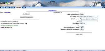

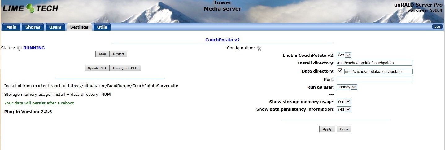

I can't really read your CP config screen post, but I have attached a screenshot of mine for you to compare.
Does the config page show that CP is running or Stopped?  If running, what happens when you click on the word Running?
