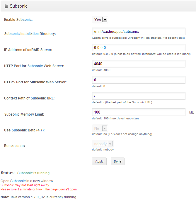

I don't usually have any problems getting plugins to work, but I am stuck at the
HTTP ERROR: 503
that some people reported early in the thread. It looks like those posters were able to get past this but it's not clear what they did.
I looked at the link in this post where it talks about a corrupted db but as far as I can tell I don't have a subsonic db.
I have attached my subsonic settings page.
Here are the permissions for my subsonic installation folder:
root@unSERVER:/mnt/cache/apps# ls -al
total 8396801
drwxrwxrwx 7 nobody users        200 2013-03-10 08:42 ./
drwxrwxrwx 6 nobody users        128 2013-03-08 23:01 ../
drwx------ 3 nobody users        464 2013-03-10 08:47 Dropbox/
drwxrwx--- 6 nobody users        288 2013-03-10 08:16 nzbget/
drwxr-xr-x 4 nobody users        400 2013-03-10 08:42 subsonic/
-rw------- 1 root   root  8589934592 2013-02-08 09:46 swapfile
drwxrwxrwx 5 nobody users        736 2013-03-10 08:46 transmission/
drwxrwxrwx 4 nobody users        144 2013-01-27 16:00 web/
and here are the contents of that folder:
root@unSERVER:/mnt/cache/apps# ls -al subsonic
total 26658
drwxr-xr-x 4 nobody users      400 2013-03-10 08:42 ./
drwxrwxrwx 7 nobody users      200 2013-03-10 08:42 ../
-rwxrwxrwx 1 nobody users     3072 2012-09-08 03:38 Getting\ Started.html*
-rwxrwxrwx 1 nobody users    35819 2012-09-08 03:38 LICENSE.TXT*
-rwxrwxrwx 1 nobody users      540 2012-09-08 03:38 README.TXT*
drwxr-xr-x 3 nobody users       72 2013-03-10 08:42 jetty/
-rwxrwxrwx 1 nobody users 10801885 2012-09-11 15:51 subsonic-booter-jar-with-dependencies.jar*
-rwxrwxrwx 1 nobody users     1081 2012-09-08 03:38 subsonic.bat*
-rwxrwxrwx 1 nobody users     5094 2013-03-10 08:42 subsonic.sh*
-rwx------ 1 nobody users 16385536 2013-03-10 08:42 subsonic.war*
-rw-r--r-- 1 nobody users    19636 2013-03-10 08:42 subsonic_sh.log
drwxr-xr-x 2 nobody users       72 2013-03-10 08:42 transcode/
Isn't something missing? Where is the db?
total 26658
It gets created when subsonic runs successfully for the first time.
Is it your first time trying this out?
Can you also post subsonc_sh.log in subsonic installation folder
This is the first time trying it out but I have installed and removed a couple of times trying to get it to work. I cleaned up previous installs completely and this is where I am after the latest install fresh from reboot.
I have zipped and attached subsonic_sh.log
Thanks
subsonic_sh.zip
Thanks
Are you using any other plug-ins that uses java?
Thanks
I have just finished searching all my .plg files and subsonic is the only one that installs java.
Also I get this for java -version
root@unSERVER:~# java -version
java version "1.7.0_02"
Java(TM) SE Runtime Environment (build 1.7.0_02-b13)
Java HotSpot(TM) Server VM (build 22.0-b10, mixed mode)
root@unSERVER:~#
