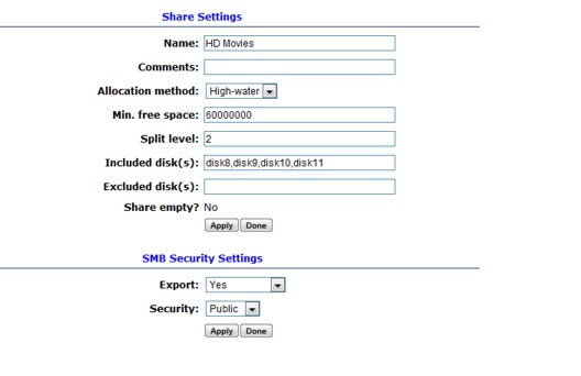

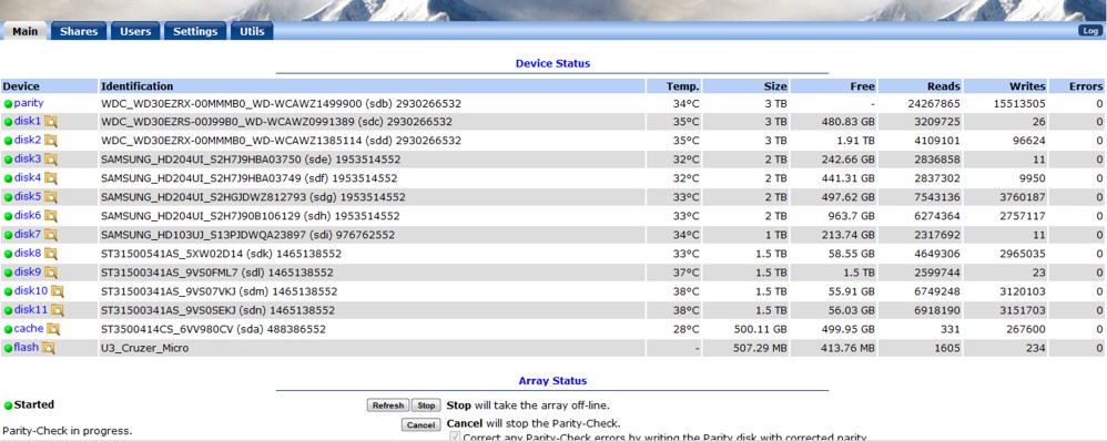

July 27, 201214 yr I recently built a new server and gradually migrating data from the old one... I set up a user share for my hd movies spanning included disks - disk8,disk9,disk10,disk11 with high water and minimum space set correctly. Three of the disks have filled in the expected high water manner but disk9 has been ignored and remains empty and the share just complained about unable to copy as out of space Any ideas?

September 4, 201213 yr Author Finally had a chance to try this, swapped disk 9 out with another previously precleared on another machine and the share is still ignored.
September 15, 201213 yr Author Now added another couple of drives precleared on my old system and now have 4 drives being ignored by the user share.
September 16, 201213 yr Author enable user shares - yes included disks - disk1,disk2,disk3,disk4,disk5,disk6,disk7,disk8,disk,9,disk10,disk11,disk12,disk13,disk14,disk15,disk16,disk17 excluded disks -
September 16, 201213 yr Not sure if you have a typo in your response, but what you included has a typo for disk9. disk8,disk,9,disk10, Remove the stray "," between disk and 9. Also, when you apply the changes, be certain to stop then start the array to ensure the changes take affect.
September 16, 201213 yr Author I think that might be it, thats the first disk I was having issues with. I'll report back.
September 16, 201213 yr enable user shares - yes included disks - disk1,disk2,disk3,disk4,disk5,disk6,disk7,disk8,disk,9,disk10,disk11,disk12,disk13,disk14,disk15,disk16,disk17 excluded disks - Leaving both included and excluded blank will include all disks.
September 18, 201213 yr Too bad the image you posted in post #4 didn't match your list you posted in post #18. Would have made life much easier seeing that extra comma at the start.
September 19, 201213 yr Author Too bad the image you posted in post #4 didn't match your list you posted in post #18. Would have made life much easier seeing that extra comma at the start. That's a different setting.
