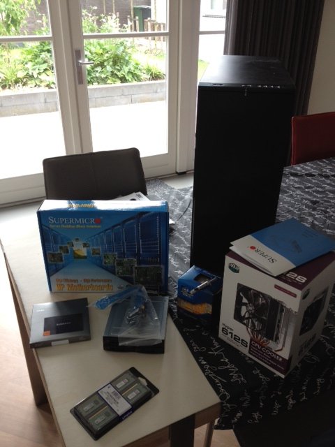

It's here !  All complete to start building ... !
