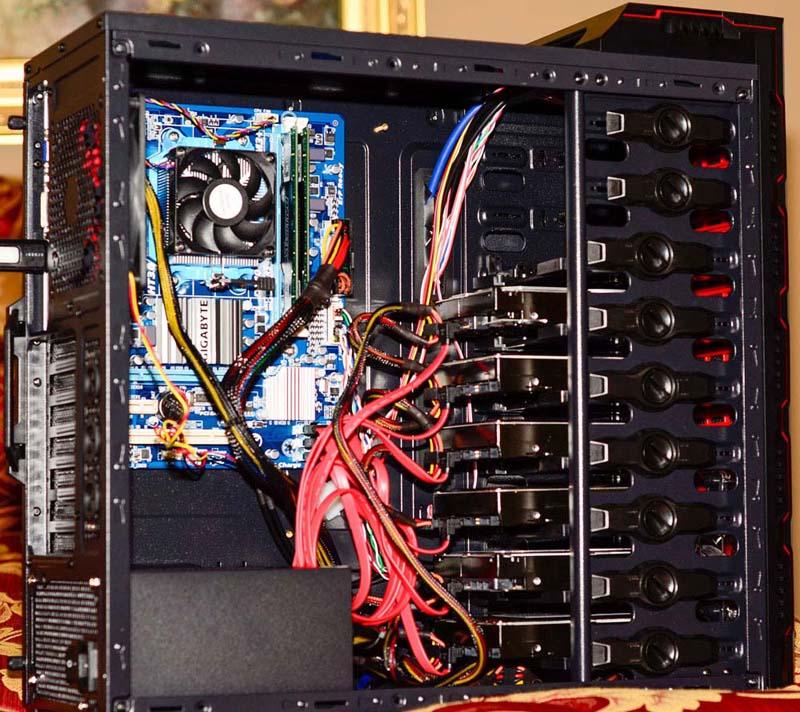

Thought I would post a quick update with a picture after my build, hopefully so other can see an inexpensive build that works.
1. Total cost for hardware was $289
2. Cost of unRAID software was $69
3. I already had all of the disks
4. System went together and booted from USB first try - no issues at all
5. Like the case a lot - for $60 it is very nice. There are three fans that come with the case and they are very quiet.  It keeps everything nice and cool.
If anyone has any questions feel free to ask, and thanks for all the help that these boards provided!

Nice build!  It sounds like you did not have any issues with the LAN chipset?  I've read that the Realtel 8111 has issues unless you're on a beta unraid... which version are you running?
Also, it looks like the SATA ports are 3.0GB/s, I realize that I HDD can't keep up with that, but I'm still green on SSDs - I don't imagine that will be a bottleneck for you?
I did not have any issues with the LAN chipset.  I was afraid I might, but I read the problems AFTER I ordered by motherboard, but no issues at all.  I am running version 5.0-rc5-r8168.
They are SATA II ports, but no issue at all for me.  This runs at home and not a multi-user system for the most part.  I use it  as a media hub to store my music and movies, as well as store backups for each computer, which run every night.
I am running a cache drive and get sustained transfer rates of between 70-90 MBs.  With a 1Gbs network, it isn't going to get much better than that anyway.  Without the cache drive I was getting between 30-40 MBs, so the parity calculations were the bottleneck there.
