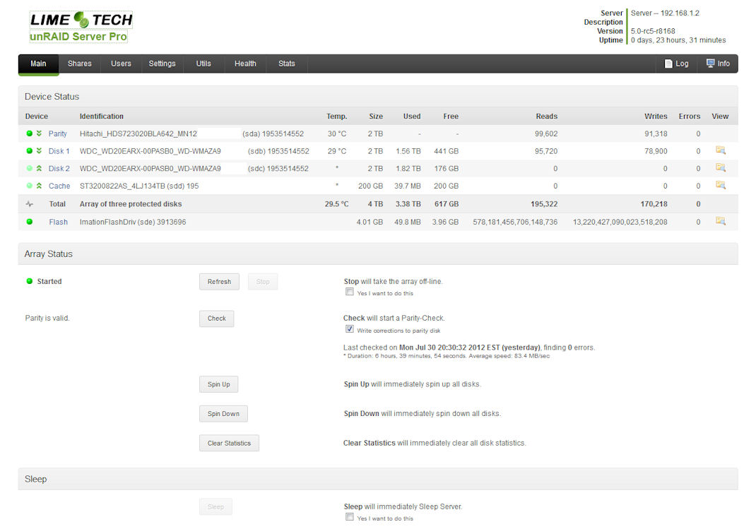

1. I'm occasionally seeing large amounts of reads and writes to the flash drive (see pic).

Please remove Simplefeatures and any other add-ons. See if the issues persist.
Thanks dgaschk, have removed all add-ons, will post back in a day or two and let you know how it goes.
Been two days now, no problems since removing simple features.
Thanks again dgaschk.
