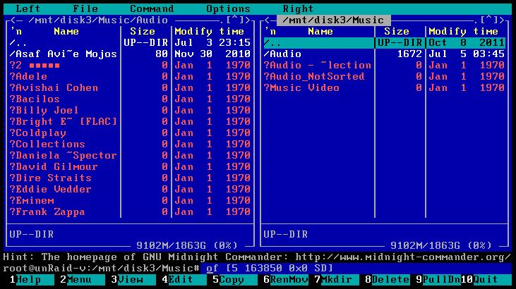

August 4, 201214 yr Hi, I have an error in my unRaid system. (currently rc6 t2, was rc5 and 4.7 before...) My whole music collection gone bad! I Get this error in the log: Aug 4 04:04:00 unRaid-v kernel: REISERFS error (device md3): vs-13070 reiserfs_read_locked_inode: i/o failure occurred trying to find stat data of [5 12023 0x0 SD] Aug 4 04:04:00 unRaid-v kernel: REISERFS error (device md3): vs-13070 reiserfs_read_locked_inode: i/o failure occurred trying to find stat data of [5 109013 0x0 SD] Aug 4 04:04:00 unRaid-v kernel: REISERFS error (device md3): vs-13070 reiserfs_read_locked_inode: i/o failure occurred trying to find stat data of [5 163751 0x0 SD] Aug 4 04:04:00 unRaid-v kernel: REISERFS error (device md3): vs-13070 reiserfs_read_locked_inode: i/o failure occurred trying to find stat data of [5 164466 0x0 SD] Aug 4 04:04:00 unRaid-v kernel: REISERFS error (device md3): vs-13070 reiserfs_read_locked_inode: i/o failure occurred trying to find stat data of [5 11695 0x0 SD] Aug 4 04:04:00 unRaid-v kernel: REISERFS error (device md3): vs-13070 reiserfs_read_locked_inode: i/o failure occurred trying to find stat data of [5 1278 0x0 SD] Aug 4 04:04:00 unRaid-v kernel: REISERFS error (device md3): vs-13070 reiserfs_read_locked_inode: i/o failure occurred trying to find stat data of [5 108485 0x0 SD] Aug 4 04:04:00 unRaid-v kernel: REISERFS error (device md3): vs-13070 reiserfs_read_locked_inode: i/o failure occurred trying to find stat data of [5 163206 0x0 SD] Aug 4 04:04:00 unRaid-v kernel: REISERFS error (device md3): vs-13070 reiserfs_read_locked_inode: i/o failure occurred trying to find stat data of [5 26 0x0 SD] Aug 4 04:04:00 unRaid-v kernel: REISERFS error (device md3): vs-13070 reiserfs_read_locked_inode: i/o failure occurred trying to find stat data of [5 11714 0x0 SD] Aug 4 04:04:00 unRaid-v kernel: REISERFS error (device md3): vs-13070 reiserfs_read_locked_inode: i/o failure occurred trying to find stat data of [5 11573 0x0 SD] Aug 4 04:04:00 unRaid-v kernel: REISERFS error (device md3): vs-13070 reiserfs_read_locked_inode: i/o failure occurred trying to find stat data of [5 11758 0x0 SD] Aug 4 04:04:00 unRaid-v kernel: REISERFS error (device md3): vs-13070 reiserfs_read_locked_inode: i/o failure occurred trying to find stat data of [5 11534 0x0 SD] Aug 4 04:04:00 unRaid-v kernel: REISERFS error (device md3): vs-13070 reiserfs_read_locked_inode: i/o failure occurred trying to find stat data of [5 11738 0x0 SD] Aug 4 04:04:00 unRaid-v kernel: REISERFS error (device md3): vs-13070 reiserfs_read_locked_inode: i/o failure occurred trying to find stat data of [5 107333 0x0 SD] Aug 4 04:04:00 unRaid-v kernel: REISERFS error (device md3): vs-13070 reiserfs_read_locked_inode: i/o failure occurred trying to find stat data of [5 164487 0x0 SD] Aug 4 04:04:00 unRaid-v kernel: REISERFS error (device md3): vs-13070 reiserfs_read_locked_inode: i/o failure occurred trying to find stat data of [5 12213 0x0 SD] Aug 4 04:04:00 unRaid-v kernel: REISERFS error (device md3): vs-13070 reiserfs_read_locked_inode: i/o failure occurred trying to find stat data of [5 107619 0x0 SD] Aug 4 04:04:00 unRaid-v kernel: REISERFS error (device md3): vs-13070 reiserfs_read_locked_inode: i/o failure occurred trying to find stat data of [5 108087 0x0 SD] Aug 4 04:04:00 unRaid-v kernel: REISERFS error (device md3): vs-13070 reiserfs_read_locked_inode: i/o failure occurred trying to find stat data of [5 12145 0x0 SD] Aug 4 04:04:00 unRaid-v kernel: REISERFS error (device md3): vs-13070 reiserfs_read_locked_inode: i/o failure occurred trying to find stat data of [5 11575 0x0 SD] Aug 4 04:04:00 unRaid-v kernel: REISERFS error (device md3): vs-13070 reiserfs_read_locked_inode: i/o failure occurred trying to find stat data of [5 108068 0x0 SD] Aug 4 04:04:00 unRaid-v kernel: REISERFS error (device md3): vs-13070 reiserfs_read_locked_inode: i/o failure occurred trying to find stat data of [5 163238 0x0 SD] Aug 4 04:04:00 unRaid-v kernel: REISERFS error (device md3): vs-13070 reiserfs_read_locked_inode: i/o failure occurred trying to find stat data of [5 163850 0x0 SD] And I cant access the files in the share folder (nor in windows ofcourse), I can only see the files in while access the disk itself but thier color in red (in midnight commander) and I can not access them. The one`s in white i can access and see in windows but they are few. See the attached MC picture. Please help me guys, I have no other backup for this collection. If you can explain the situation and offer a solution i will be greatful! Thank you, Shlomi

August 4, 201214 yr The disk is perfectly fine. It you now need to check the file-system on the /dev/md3 and repair it, if it indicates a repair is necessary. http://lime-technology.com/wiki/index.php/Check_Disk_Filesystems
August 4, 201214 yr Author Ran the test, had several errors. Ran it in a VM Console and not putty so I can copy nor go up the output text. In the end it said it found 1 error which must be corrected using rebuild_tree. I will now run rebuild tree. Hope I wont fuck it up.
