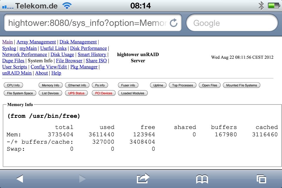

I had a look at the syslog but from there I can't see what happened. Where else can I probably see the problem? Are there any mystic console commands that will show up what really happens? So far the only thing I see is, that almost all of the computer memory is in use.
Total: 3735404
Used: 3611440
Free: 123964
Shared: 0
Buffers: 167980
Cached: 3116460

The cached ram isn't an issue, it doesn't matter if you have 1 GB or 8 GB linux will use it all for cache unless needed.
Are you sure? I did a restart yesterday and for the first 30 mins the ram wasn't cached. See Screenshot.

The cached RAM is definitely not an issue. It is used as needed, if available, for caching disk reads. It is made available to process as needed and process release RAM making it free again (hopefully). To understand the graph take a graduate level Operating Systems class and then install a kernel debugger on the system.
