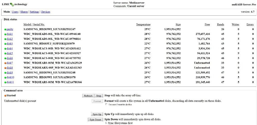

I have had a twin hard drive failure.
One went red and one went orange and alll the content of both disapeared off the array.
I have not been able to unmount them to do any checking so I am assuming there has been some file system problem with at least one of the drives.
The good news is I have mounted them in my windows box and retrieved the data off them.
Situation is of now.
Disk 8 was 1TB and has been replaced with a new 2TB EARX dot changed from red to orange.
Disk 7 was orange, has been backed up and reinstalled.
I can start the array and it gives me the option to format the unformatted drives but on refresh nothing has happened.
I don't have unmenu currently installed.
I have never used the preclear/
I have never changed jumpers on the drives.
Next step before I break something?
Should I be looking at changing the drive jumpers over on the EARS and EARX's?
