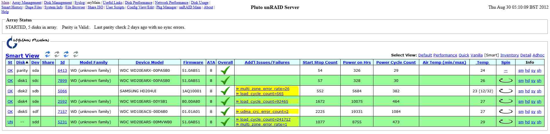

I'm new to unRAID but enjoying the experience so far, in the process of migrating my data and drives to my server I've noticed a couple issues with a couple of drives.
I decided to have a look on the WD Site to see if there were in warranty and to my surprise they were:
WCAV5D092592 WD10EARS-00Y5B1  IN LIMITED WARRANTY 06/18/2013
WCAZA4585231 WD20EARS-00MVWB0 IN LIMITED WARRANTY 03/15/2014
The Smaller and the oldest of the drives is the 1TB, it has a Power on count of 419.25 days and an LCC of 92449, i have only just run WDIDLE3 /S300 on thsi drive.
    9 Power_On_Hours          0x0032  087  087  000    Old_age  Always      -      10062
193 Load_Cycle_Count        0x0032  170  170  000    Old_age  Always      -      92449
The next drive is my 2TB that has just come out of my main machine and is currently in the server running ./preclear_disk.sh -A -c 3 /dev/sdX like all my drives that have gone into the server, this drive has a Power on Count of 364.25 days but has a LCC of 241712 and a MZER of 1.
    9 Power_On_Hours          0x0032  089  089  000    Old_age  Always      -      8742
193 Load_Cycle_Count        0x0032  120  120  000    Old_age  Always      -      241712
200 Multi_Zone_Error_Rate  0x0008  200  200  000    Old_age  Offline      -      1
Neither of the drives have ever given me any issues so far but i would like some piece of mind.
Should i RMA them and if so how do I go about this as I have never done anything like this before, what reason / comment do i pick for the return as I don't really want the drive rejected and  returned for any reason.

Had a closer look at the 2TB Samsung drive also and It's in warranty also,
Serial Number                  Seagate Part Number      Warranty Status
S2H7J90B825066  HD204UI                          In Warranty  Expiration 22-Nov-2014
I have noticed a few attributes change on this drive since installing it in unRAID, the Raw Read Error Rate used to 0 (26/08/12) and is now 2, and the Multi Zone Error Rate used to be 7 (26/08/12)
  1 Raw_Read_Error_Rate    0x002f  100  100  051    Pre-fail  Always      -      2
200 Multi_Zone_Error_Rate  0x002a  100  100  000    Old_age  Always      -      26
Should I be concerned also about this drive and get it RMA'ed?

And in neither case has the normalized value of 100 changed.  In other words, all drives have raw read errors.  Until the current normalized value reaches the associated failure threshold, the manufacturer considers the drive to be working as expected.
Don't RMA, learn more about SMART values instead.

Looking at the report below for my Samsung drive what values should i be looking at and keeping an eye on?
I'm always willing to lean just need a little help learning  :D
Any info you can point me at that breaks this stuff down for me so I can learn from is appreciated.

So there's noting to worry about in MyMain then?
On a side note why isn't there a Model Family showing up all i get is WD (unknown family), when i see others MyMain screen shots the data's there.
Any help understanding the smart reports is appreciated.
Your drives look ok. SMART is not as easy as it sounds, try and read up on it.
In the meantime "pending sectors" and "offline uncorrectable" are a sign that something is going on.
Thing is that the trend is far more important then the absolute value, it you have an uncorrectable sector then the drive will function without an issue and if it remains with that one sector there is no issue. These figures become important if they change over time, when they grow examine..
It's a bit like skin cancer actually.. No problem with a mold, but if it changes, or more appear, go see a doctor .. (thats good advice btw guys..)
Thanks for the reply, good to know I have nothing to worry about at the moment.
I have the smart history plugin installed so I'll keep an eye on that.  When you say the trend is important over raw values ate you referring to if I see a steady increase in the numbers I should be worried.
Are the raw values not as important then, what values should I be looking at when I get a smart report?
I will have to have a read up on smart, can you recommend a good source?
Does anyone know why the Model Family isn't showing up all i get is WD (unknown family), when i see others MyMain screen shots the data's there?
RAW values are dangereous to interpret, they do not mean the same for every drive.. And a certain amount of "failure" within a drive is ok, that is the way the disk was created..

So on the below report what values should i be keeping an eye on then?

Other than the WHEN_FAILED column, watch Current_Pending_Sector and Reallocated_Sector_Ct
Hi and thanks for reply.
I take it something will appear in the WHEN_FAILED column when there's a problem?
What do the values in VALUE, WORST and THRESH represent then?
