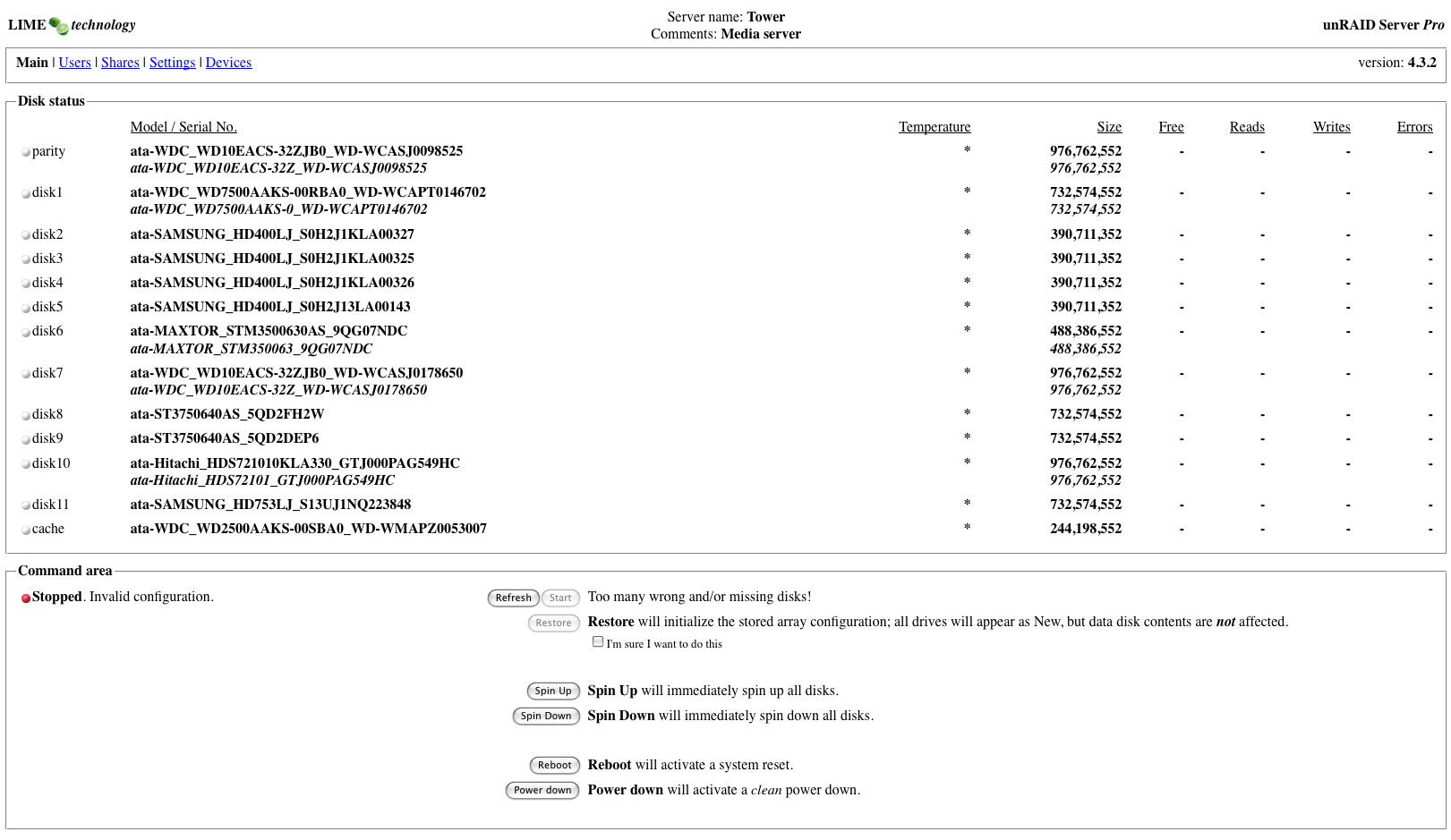

http://www.wedontlikeu.com/images/unraid/unraid.JPG
Edit: Heh, caught the screenshot at a bad time; the ones with the different names are flashing red, the others are not.
So for mine here, assuming I'm not overly worried about parity, I can just go ahead and click "Restore", and I won't lose any data?
As long as the parity drive is in the parity slot you will not lose data. (and I can see from the screen shot it is)  Pressing "restore" will immediately start the process of re-computing parity.
