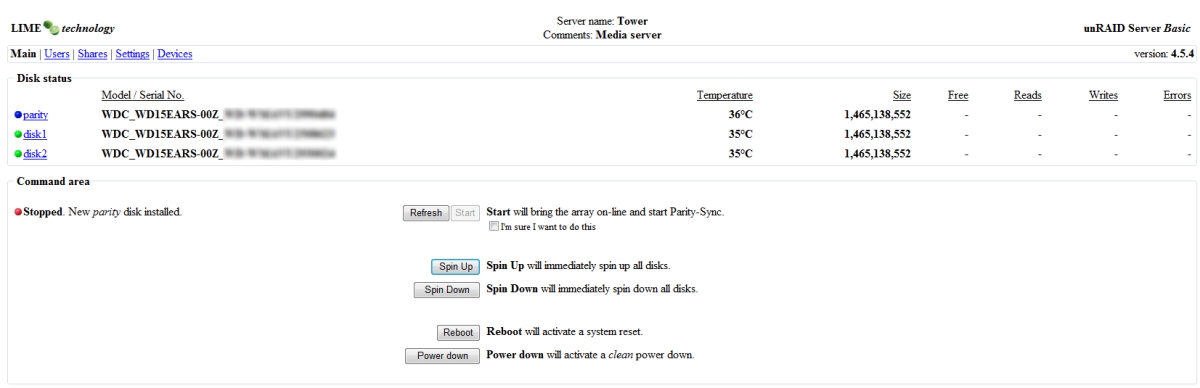

Was your parity installed with a green ball when you shut down the server? It sure appears that the server was started without the parity drive since there is no indication of the previous parity disk info and that usually shows up in italics under the new drive info when you replace a drive.
At any rate, you have a pending bad sector on the drive. You can run the preclear and see if it gets reallocated and the drive is stable or you could just click the check box and hit start and see what happens.
One other important thing, make damn sure you haven't somehow swapped the parity and one of the data drives because any writing to the parity with data on it will desctroy that data. If you're not sure, unassign the parity and start the array first and make sure your data disks are ok.
I have been copying and reading files from the server before i turned it off, so I assume that the parity drive was working (I only checked the WebUI after the server stopped)
It's been a while since I ran preclear (I still have the commands saved in a file I created but how can I tell if the errors persist afterward?  Do I then run another S.M.A.R.T. test on the drive or just assume that it is good after the preclear?
It it the same drive, I checked with the screenshot that I took when I created the server.

S.M.A.R.T. test results that was run after the Preclear
=== START OF INFORMATION SECTION ===
Device Model:    WDC WD15EARS-00Z5B1
Firmware Version: 80.00A80
User Capacity:    1,500,301,910,016 bytes
Device is:        Not in smartctl database [for details use: -P showall]
ATA Version is:  8
ATA Standard is:  Exact ATA specification draft version not indicated
Local Time is:    Thu Sep 13 04:46:08 2012 GMT+8
SMART support is: Available - device has SMART capability.
SMART support is: Enabled
=== START OF READ SMART DATA SECTION ===
SMART overall-health self-assessment test result: PASSED
General SMART Values:
Offline data collection status:  (0x82) Offline data collection activity
was completed without error.
Auto Offline Data Collection: Enabled.
Self-test execution status:      (  0) The previous self-test routine completed
without error or no self-test has ever
been run.
Total time to complete Offline
data collection: (33600) seconds.
capabilities: (0x7b) SMART execute Offline immediate.
Auto Offline data collection on/off support.
Suspend Offline collection upon new
command.
Offline surface scan supported.
Self-test supported.
Conveyance Self-test supported.
Selective Self-test supported.
SMART capabilities:            (0x0003) Saves SMART data before entering
power-saving mode.
Supports SMART auto save timer.
Error logging capability:        (0x01) Error logging supported.
General Purpose Logging supported.
Short self-test routine
recommended polling time: (  2) minutes.
Extended self-test routine
recommended polling time: ( 255) minutes.
Conveyance self-test routine
recommended polling time: (  5) minutes.
SCT capabilities:       (0x3031) SCT Status supported.
SCT Feature Control supported.
SCT Data Table supported.
SMART Attributes Data Structure revision number: 16
Vendor Specific SMART Attributes with Thresholds:
ID# ATTRIBUTE_NAME          FLAG    VALUE WORST THRESH TYPE      UPDATED  WHEN_FAILED RAW_VALUE
  1 Raw_Read_Error_Rate    0x002f  200  200  051    Pre-fail  Always      -      30
  3 Spin_Up_Time            0x0027  183  180  021    Pre-fail  Always      -      5825
  4 Start_Stop_Count        0x0032  100  100  000    Old_age  Always      -      180
  5 Reallocated_Sector_Ct  0x0033  200  200  140    Pre-fail  Always      -      0
  7 Seek_Error_Rate        0x002e  200  200  000    Old_age  Always      -      0
  9 Power_On_Hours          0x0032  081  081  000    Old_age  Always      -      14571
10 Spin_Retry_Count        0x0032  100  100  000    Old_age  Always      -      0
11 Calibration_Retry_Count 0x0032  100  253  000    Old_age  Always      -      0
12 Power_Cycle_Count      0x0032  100  100  000    Old_age  Always      -      32
192 Power-Off_Retract_Count 0x0032  200  200  000    Old_age  Always      -      13
193 Load_Cycle_Count        0x0032  200  200  000    Old_age  Always      -      2085
194 Temperature_Celsius    0x0022  114  107  000    Old_age  Always      -      36
196 Reallocated_Event_Count 0x0032  200  200  000    Old_age  Always      -      0
197 Current_Pending_Sector  0x0032  200  200  000    Old_age  Always      -      0
198 Offline_Uncorrectable  0x0030  200  200  000    Old_age  Offline      -      1
199 UDMA_CRC_Error_Count    0x0032  200  200  000    Old_age  Always      -      0
200 Multi_Zone_Error_Rate  0x0008  200  200  000    Old_age  Offline      -      2
SMART Error Log Version: 1
No Errors Logged
SMART Self-test log structure revision number 1
Num  Test_Description    Status                  Remaining  LifeTime(hours)  LBA_of_first_error
# 1  Short offline      Completed without error      00%    14571        -
# 2  Short offline      Completed: read failure      10%    14536        481279079
SMART Selective self-test log data structure revision number 1
SPAN  MIN_LBA  MAX_LBA  CURRENT_TEST_STATUS
    1        0        0  Not_testing
    2        0        0  Not_testing
    3        0        0  Not_testing
    4        0        0  Not_testing
    5        0        0  Not_testing
Selective self-test flags (0x0):
  After scanning selected spans, do NOT read-scan remainder of disk.
If Selective self-test is pending on power-up, resume after 0 minute delay.
Your disk looks fine, but I think you are using a VERY OLD version of the preclear script.  Please download and use the most current.
There was one sector where the contents did not match the checksum at the end of that sector...  It was able to be re-written in place, so no re-allocation was needed.
Joe L.
Thanks for all of the help guys, I will update the preclear.sh file.  Are there any benefits to upgrading the system to v4.7, or "if it ain't broke, don't fix it" should apply?
We have absolutely no idea...  since we have no idea which version of unRAID you are currently running.
Every version of unRAID fixed something....
See the release notes in the wiki for details.
Found you gave the release in the first post in this thread... (sorry)
There were 13 versions of unRAID between yours and 4.7.
If your server is working correctly for you, you probably do not need to upgrade unless one of the bugs is causing you to experience errors.
