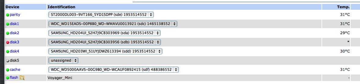

Had I/O errors on drive 3 (hdb) which effectively failed. Although seemed fine before the update.
Parity is showing green as well as other disks showing green.
I rebooted ( :( ) and it said there was an unformatted drive.
I formatted ... disk is red.
I went to try and initiate rebuild from parity by deselecting and reselecting disk, but the disk show as 'Not present' even though the bios sees it and it previously formatted by unraid??
Can I still rebuild it from parity?
If so what next please  ::)

So it looks like the array is currently ONLINE .. is that correct?  Will he want to restart the array in Maintenance Mode?
Array is stopped at the moment, trying to source a machine to read this disk .... :o
