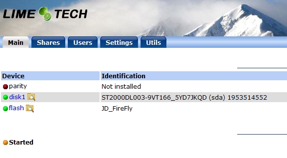

Parity is already unassigned.  Please see attached screenshot.
I haven't reassigned the 3TB parity disk since your post on 9/22/12 asking me to try without parity because reassigning parity would require a parity rebuild (multiple hour delay).
