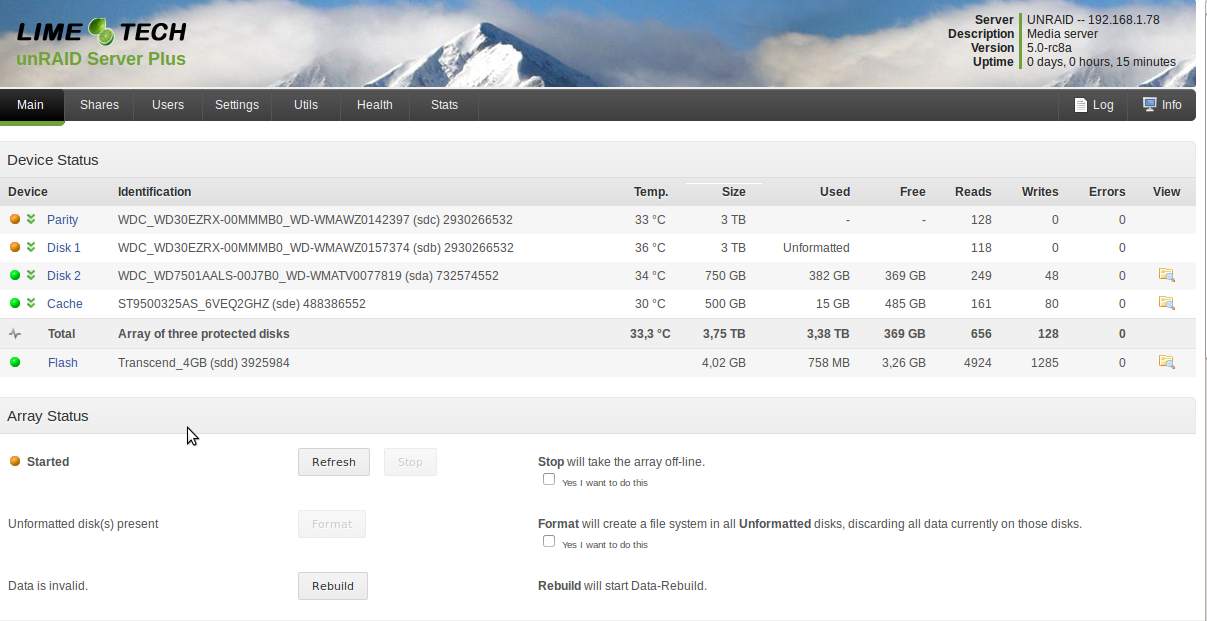

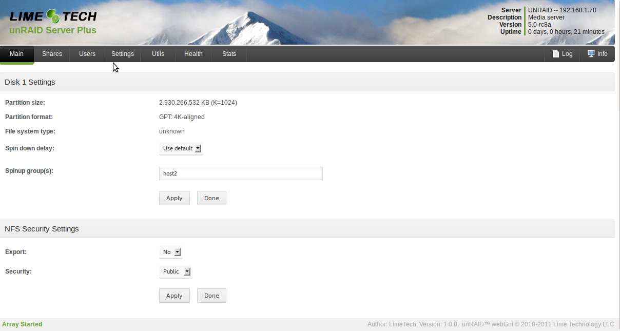

A red dot appeared on my Parity drive. I stopped the array and rebooted the server. A blue dot appeared next to the Parity drive and I start a parity sync. What I saw was a very slow and unusual speed at about 15-20 mb, while usually I have at arround 120. I did stop the parity sync and rebooted the server once more. What i saw was that this time not only the parity drive was orange, but also Data Disk-1 (WDEZRX) was red saying it is unformated.  On the web interface for Disk 1 i see the following: File system type: unknown

I am attaching a screenshot of my web interface:
