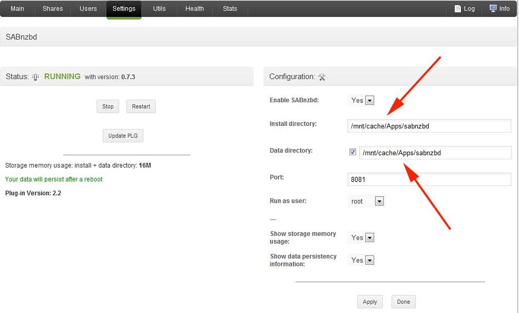

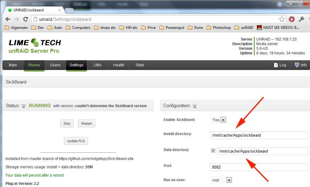

Ok, no panic :) first things first. I've read from your other post(s) that you have installed both sickbeard and sabnzb to your cache drive, but by the looks of it, you are only using the cache drive as data directory, and you have not actually installed the 'programs' there. I would suggest you make sure the programs are installed on the cache drive as well, this will make it easier navigating and explaining.
Go to the settings in simplefeatures, for both sab & sick, and make sure the install and data folder are on the cache drive and press apply. This will (re)copy/install everything to the cache drive.
Now you can at least navigate and browse from your explorer. If you have done this, and you can actually find the sickbeard and sabnzbd folders using your windows explorer, let me know and i'll walk you through the rest.

what do you have for "data directory" in the settings?  refer the the sreenshots posted by jowi
Here are the settings that I have
Ok, change Install directory from /usr/local/sabnzbd to /mnt/cache/apps/sabnzbd
Do the same with sickbeard's settings, so BOTH are installed on the CACHE disk.
Press apply on both.

*EDIT* Okay I have changed the install directory to what you said so it is now the same as the DATA directory. However, when I do that, the data directory for some reason gets unchecked.
*** Yes, it seems like the DATA folder gets unchecked right away, so I can't have them pointing to the same folder?
Okay so I added another /data, to the data folder so that the install and data folder aren't the same, and it stayed this time.
So the plugins are now installed to the cache drive.

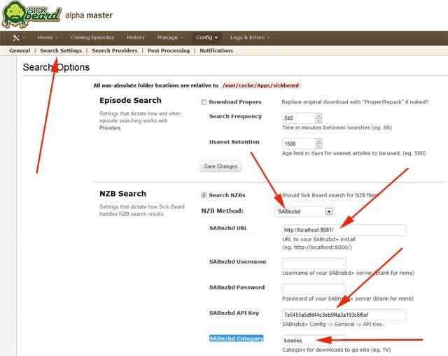

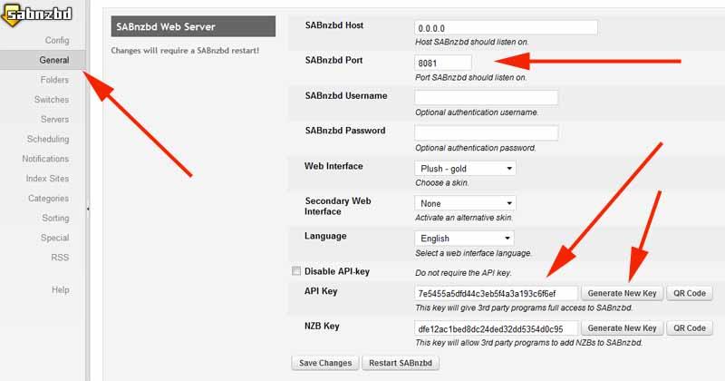

First, go to sabznbd settings, 'general', SABnzbd Web Server, and generate an API key (press generate key), and copy that key to the clipboard.
Then, goto SICKBEARDSearch Options, fill the copied key in the SABnzbd API Key field and set http://localhost:8081/  for SABnzbd URL.
Fill in the SABnzbd Category name with e.g. 'tvseries'. We need that later on.
Press save changes, and see if sickbeard can 'find' sabnzbd by pressing the 'TEST SABNZBD' button.

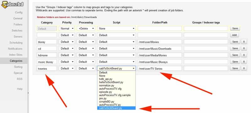

Now go to sabnzbd, and add a categorie for 'tvseries' with the SAME name you've used in sickbeard. This will make sure that when sickbeard sends it's nzb to sab, sab will 'treat' it as a tv serie, and call the appropriate post processing script.
Choose 'sabtosickbeard.py' as script, and enter your UNRAID TV SERIES USER SHARE path in the folder/path.
The script will basically give the control back to sickbeard, once it is downloaded.

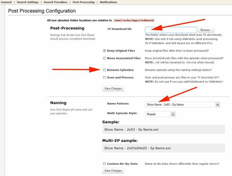

Now go to sickbeard's settings again, and go to the post processing part.
Enter the location of your unraid tv series shared folder, .e.g. "/mnt/user/TV Series" in the TV download dir.
(mine is empty because i wrote my own post processing ;) )
Tick the 'rename episodes' and scan and process checkboxes. This will rename your episodes and fill in the episode title (which usually is missing).

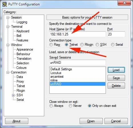

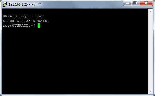

Now you have to telnet into your unraid server...  do you have putty installed?
If not, get it here : http://www.chiark.greenend.org.uk/~sgtatham/putty/download.html
and create a session with the ip adress of your unraid machine, and open the connection, use 'root' as password when you log in...
*edit*  or maybe if you go into the plugin settings and make sickbeard run as 'nobody' in stead of 'root', the folder is accessable?
thanks bud.
Yep, putty is installed. I used it to install screen for preclearing...
I typed in root and ready for your instructions
;D
ok, navigate to the sickbeard folder, if i'm correct:
cd /mnt/cache/apps/sickbeard
and enter the command:
chmod 777 autoProcessTV
go into the folder:
cd autoProcessTV
chmod 777 *.*
(now i will get comments of angry linux purist fans but hey... who cares :) )
If all is well you should now be able to open the folder and edit the .cfg file.
