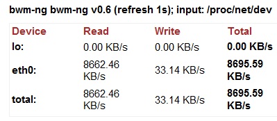

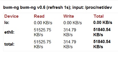

i found that, during slow period i captured the display of the network monitor
Also i looked with the command "top" and saw the following:
Cpu(s):  7.1%us,  0.3%sy,  0.0%ni, 90.0%id,  2.6%wa,  0.0%hi,  0.0%si,  0.0%st
Mem:  16608292k total,   354884k used, 16253408k free,      384k buffers
Swap:        0k total,        0k used,        0k free,   300304k cached
