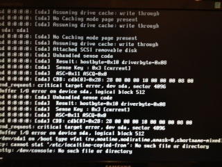

Im getting this error when trying to boot rc5 or latest rc (see attachment)
Whats wrong?
Getting scared this wont run :( using ASRock 880GM-LE FX mobo

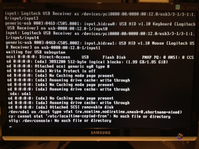

Now getting this
Rajahal, could u help me here please?
Is this a hardware issue? Bios setting issue or usb stick issue?
Thx for any help!
Is this your first time setting up unRAID on this computer?  Is your USB drive labelled UNRAID?  Can you try a different USB stick?  It's kind of hard to know what could be wrong with the amount of information being provided.

Detach those other USB devices, i.e. the logitech usb receiver etc and try and ensure the USB stick is the only thing connected via USB.  Definitely try another stick as well - I don't believe a different version is going to resolve your problem as the issue would seem to be read/write from the mounted stick.

I reinstalled the usb stick
And detachef the keyboard and now its booting correctly, dunno why
Thx
I'd suggest it was trying to mount the Logitech USB receiver as the boot stick :)
