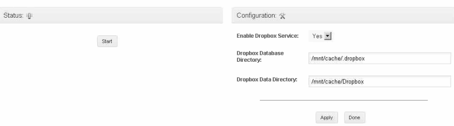

I've installed this new plugin, and everything goes well (no errors or anything). I can see the dropbox link under Settings on the unRAID web GUI just fine. Under configuration, I have the database set to /mnt/cache/.dropbox and the data set to /mnt cache/Dropbox. I enabled the drobox service, and I got two notifications: "starting dropbox service..." and "...OK." However, I do not get the URL to link it to my dropbox account. Everything appears to be working, except for actually linking it to my account. Any ideas?
i had to restart dropbox to see the link.
I've restarted multiple times. There is a "status" section with a lightbulb icon that I assume lights up when everything is running, but it's not lit up. I change the Enable Dropbox Service from Yes to No, hit apply, and it tells me the service stops. I change back from No to Yes and apply, and it tells me the service starts back up, but still no link.
... I got two notifications: "starting dropbox service..." and "...OK." However, I do not get the URL to link it to my dropbox account. Everything appears to be working, except for actually linking it to my account. Any ideas?
Strange.  After starting the status line should read: " Status:  Waiting to be linked to an account...  [Click to open link in new page]"

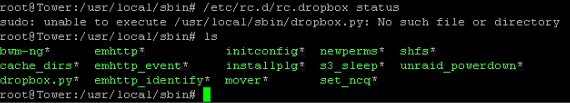

OK, I removed files as you specified, rebooted my server, and saw that everything is reinstalled. I double checked the /flash/config/plugins/dropbox, /usr/local/sbin and /usr/local/dropbox locations, and saw all the files you mentioned. Everything was there as described.
I ran
/etc/rc.d/rc.dropbox status
and it returned the same thing as before: No such file or directory. I browsed to /usr/local/sbin/ and verified that there is indeed a dropbox.py file (screenshot attached)
Are you running any other plugins?
The only thing I can think of is that it's having trouble executing dropbox.py file and in that case perhaps there's something odd with the version or installation of python on your system.
python --version
from command line should tell you the version of python installed.  For me, I get "Python 2.6.6" as a message back.  The dropbox plugin downloads & installs python 2.6.6.  It stores the downloaded copy on your flash drive as /boot/packages/python-2.6.6-i486-1.txz.  Check to see if it's present.  Perhaps also remove this as well as the other files mentioned in my earlier post and try once more to reinstall.  FWIW, I've just performed a fresh install onto a DEV unraid using the plugin in the first post and it's installed ok and I'm able to run dropbox status command without issue.
Keep at it, as it must be something fairly basic which is preventing the plugin from doing it's job.
It is now up and running! Apparently something (either this dropbox plg or another plugin) had downloaded a bad copy of python-2.6.6.i486-1.txz. I deleted all the files you mentioned in your previous post along with the python package and rebooted the server. Once it came back up, your plugin downloaded dropbox and python and everything installed correctly. Thank you very much for your troubleshooting help! Great job on the plugin  :)
Excellent news!  Happy to hear you got to the root cause and glad I was able to help.
