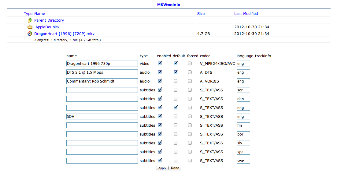

the plugin version on github (see my signature) does now use the latest mkvtoolnix release ( v5.8.0 )
well, not latest, since 5.9.0 was released yesterday (argh :) ). (will update to that package, as soon as a slackware package has been released)
but until the webgui is finished, you can already use the plugin to install mkvtoolnix and use it via telnet
(the plugin does include a VERY early version of the webgui, where you can at least display the file properties (no changing included yet).)

lately i've changed a lot from my first attempt to write a web gui for this. the version i'm currently working on requires simple features (mostly because i'm using the jquery library included there)
