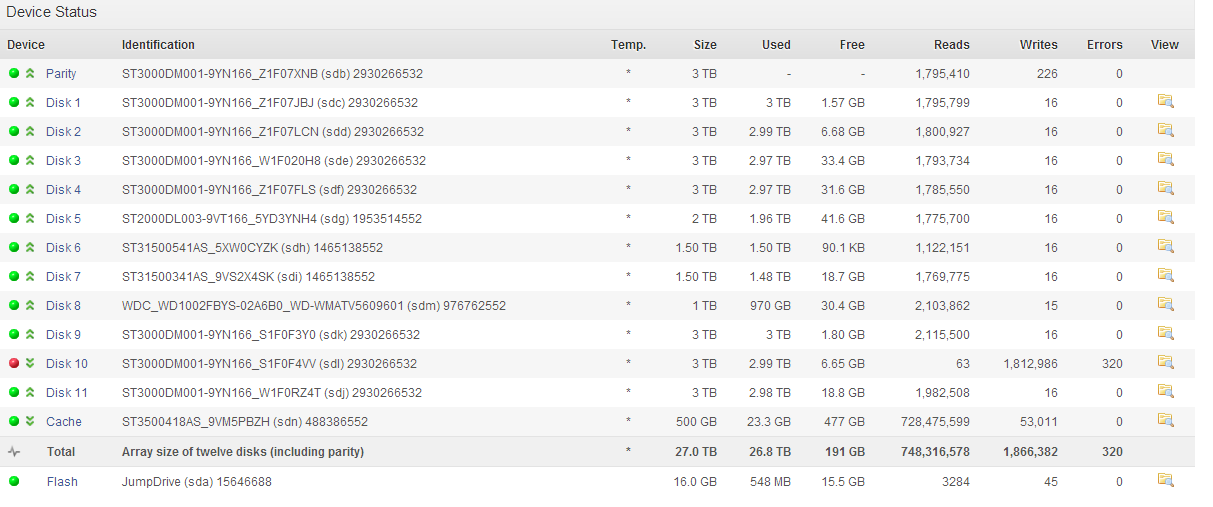

I tried rebuilding the drive it said it would take 23 hours, I checked on it later and it failed while rebuilding.
Please see the attached picture where it shows that the problem drive is (sdl).
However when I check the syslog, it tells me I am having problems with drive (sdn) and does not mention drive (sdl). The sys log just repeats these errors over and over again.
