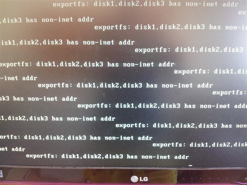

This morning I hooked a monitor and keyboard up to it and this is what was on the screen.
Seeing as there was no activity on anything, I did a hard reset on the box. Everything ooks like it is back to normal. I will attempt the preclear again.
