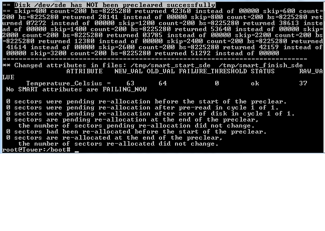

Hello, noob here .. i apologize this post probably won't have everything needed to get my problem fixed but i just started the setup process for unraid, put all my disks into the array (most have been used for 1 year or so now as windows shares), and started the preclear process. 3/4 went fine, one came up and said preclear not successful. i've attached a screenshot of hte error from screen, but i'm not sure how to get a full text log. i can't get the SMART report to work for some reason. again, i apologize, don't know much about what i'm doing. i attached the system log from unmenu, not sure if that's helpful or not....
i started a preclear on the drive again in case it was just a mistake... do the errors shown indicate a failed drive? or something else...?

If the temp listed there is the HDD temp, I would suspect it overheated.
But I am also relative noob for this kind of stuff. wait for the brilliant people to chip in.
The raw value is the temp.  It is fine (37C).  The issue is all the expected 0000 returned XXXXX.
The post-read verify expected all zeros.  Lots of other junk was being returned instead.
It might be the disk itself, or the disk controller, or the power supply, or memory, or memory is not set with its appropriate voltage, timing, or clock speed.
In any case, it will drive you bananas if you tried to verify parity with that type of error, as random bytes are being returned from the disk.
Step 1.  Run a memory test, preferably overnight.  No errors should appear.    If they do, verify the memory voltage, timing, and clock speed are as needed by your specific make and model RAM. (Most BIOS set them correctly, some do not)

I know.  The post-read phase was added to the preclear script after another user found a disk that acted up after being assigned to the array.  It would randomly return various values for the same data blocks.  (almost like some Microsoft Products)    It drove him crazy, as he had to first isolate the disk causing the random parity errors.

Yes, it is most likely the disk itself or the disk controller port it is connected to, but you can swap ports and see if the issue follows the port, or stays on the same disk.

OK... so being as it were that i was going to be gone all weekend i figured I would toss the disk with unsuccessful test through another preclear cycle, just to see if it returned the same thing or not... the odd thing is, this time it was successful.
any thoughts? should i have concerns here? should i proceed and just build the array (onward and upward?)?
thanks!
This makes me think that it could still be a memory issue of some sort (or a bad cable connection, etc).  Do you have any other drives to preclear?  If so, run them through and see what you get.
I still think you should probably test the memory overnight as Joe recommended too.  Unless the data isnt that important to you.  ;)
the other drives all ran preclear fine the first time, four of them (2tb each).
and yeah, i had to wait for my unraid registration file last night anyways when i got home so i set memtest to run... it was still going in the morning on test 8 or so, but 0 errors so far.
i should probably note that toward the end of the preclear cycles (i ran all four at once) i did start the fifth drive up, so maybe that screwed up the preclear of the other drive? but it may have already been failed at that point, i can't remember. i do know that the wiki said not to run more than 4 at once but i figured it'd be alright during the post-read cycle... maybe i'm just dumb hah
Well i believe running too many at once will use up too much memory, so yeah, maybe thats what happened.  The most I've ever run at once was three and I probably won't do that again.
The post-read is where it is using the MOST memory, as it has to verify what was written.    You might have exhausted your memory by running 5 without limiting the resources the preclear was using by use of the "-r" "-w" and "-b" options.
