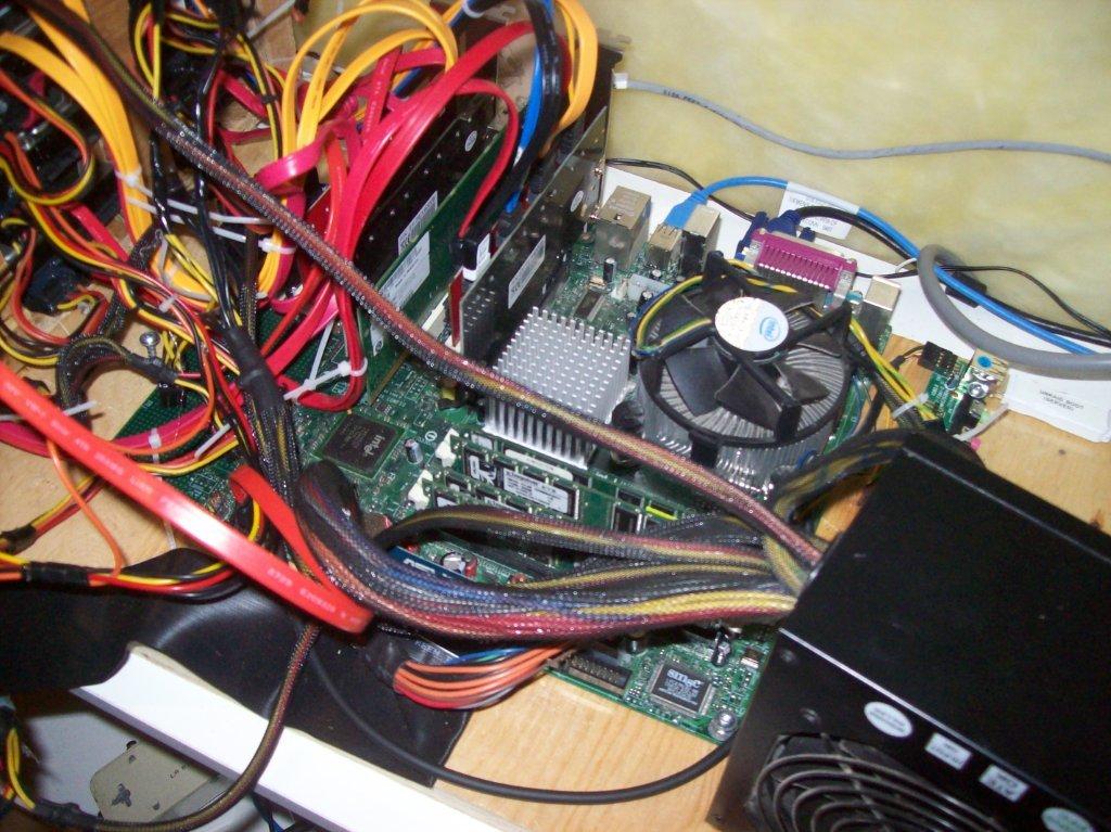

Power Supply: With this many hard drives, there is inevitably going to be some issues with the 12V line.  The thermaltake 750 has multiple 12v rails, but only a single 20A rail dedicated to the molex connectors, what I chose to do instead was to take the power connector that would normally feed a PCIe video card, add the 5V line from the floppy connector, and create another chain of power connectors.
Also, there are absolutely NO plug in power splitters anywhere in the system (with the exception of the fans).  Whereever I've split the power feeds, the wiring is soldered to each other (Powersplitters are inherently flakely, and also induce voltage losses which are mitigated by using wires soldered to each other)

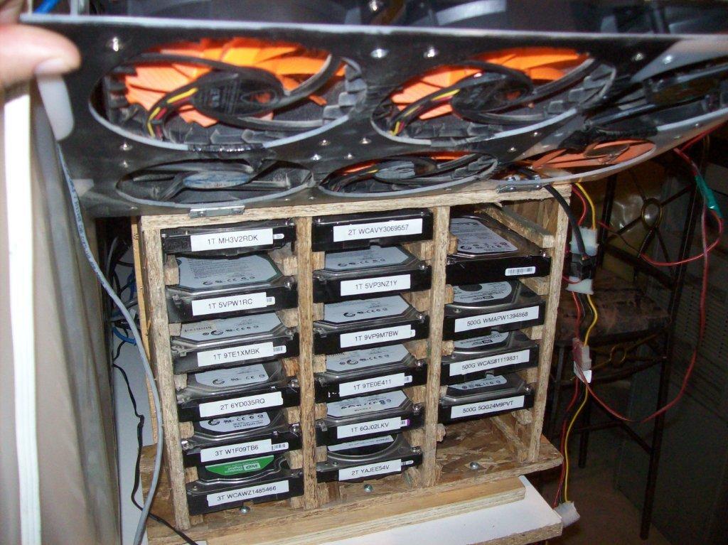

Harddrive Rack:  Quite obviously home built (and I am no carpenter), but designed for ease of access with the flip up fan door

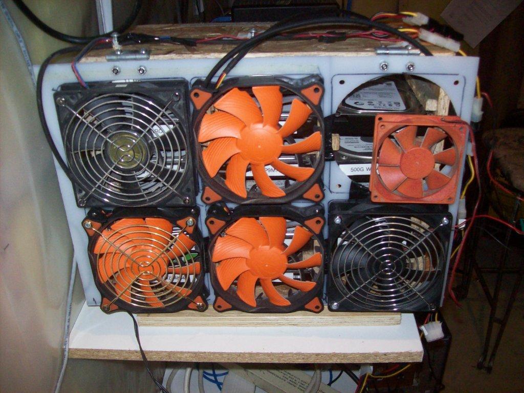

Cooling: They're standard 120mm fans (and a single 80mm - haven't gotten around yet to replacing it with a 120mm).  Instead of drawing power from the powersupply, they are connected to a 9V Walwart.  This effectively lowers the speed and noise output from the system while ensuring that the maximum harddrive temperature I've ever reached is 31C.  At some point, I think I'll get around to buildiing a temperature controller for each fan to adjust the speed automatically.

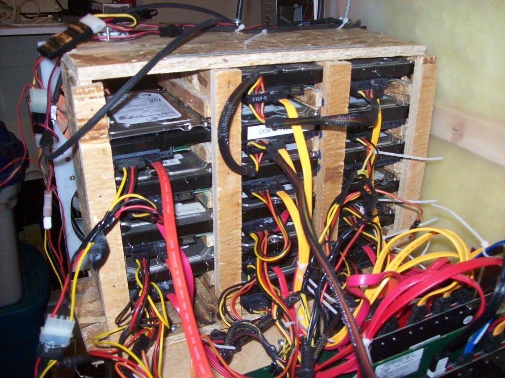

HardDrives:  Since I'm not using a case with a backplane, I found that I was having some intermittent issues after the build with the power connectors at the harddrives coming loose.  This was solved with just a drop of hotglue to hold the connectors in place while still allowing relatively easy disconnects in the event of a drive failure.
Controllers:  I was originally using all PCI controllers, but while read speeds were awesome, write speeds were ok, but parity check speeds were in the toilet.  So, as extra funds have freed up, I have switched over to the PCIe controllers.  Luckily for a MB this old, I really lucked out in that it had a PCIe x16, and 2 PCIe x1 slots.
NIC: The onboard NIC is only 100MB/s, so I really had no choice but to add an expansion card to upgrade to 1GB/s.  I had a PCIe card available, but unfortunately all of my slots were taken up by the controller cards.  But I canabalized my old Dell PowerEdge 2800 Server for its PCI-X card (Nice Xeon server I originally bought at auction for $50, but unfortunately its backplane only accepts SCSI drives).  I just put electrical tape around the edge connectors that weren't used.

Looks good to me, the 80mm really looks out of place though :-)

Looks excellent.  Probably easier to manage a disk replacement than almost any other arrangement.

You made that 6-fan mount?

Yeah, I know the 80mm looks really strange there.  I just haven't made the trip down the street to the local store to grab another 120mm.  Too lazy.

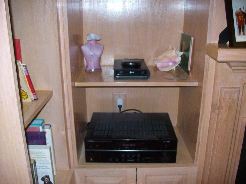

And just so you guys don't think that I'm a complete wiring slob, here's the only visible part of the main HTPC.  All anybody can see is an external blu-ray drive with the IR receiver sitting on top.  I lucked out in that my server (furnace) room is directly behind the rec room, so it was super easy to hide the actual computer and wiring for the receiver.
My other HTPC's are using "real" HTPC cases with LCD displays, but this is the one that looks the best because its so minimalist.

One thing i thing I would change about the "drive rack". I think I would have the drives slide out the side with the cables and have the fans just screwed to the wood frame. I would not bother with the hinged fanwall door (I'm not saying it is a bad idea, I am just thinking more like KISS).
the downside to my idea is that possibility of knocking a connector loose on an another drive. that might already be a problem if one has an untidy cable nest anyways.
