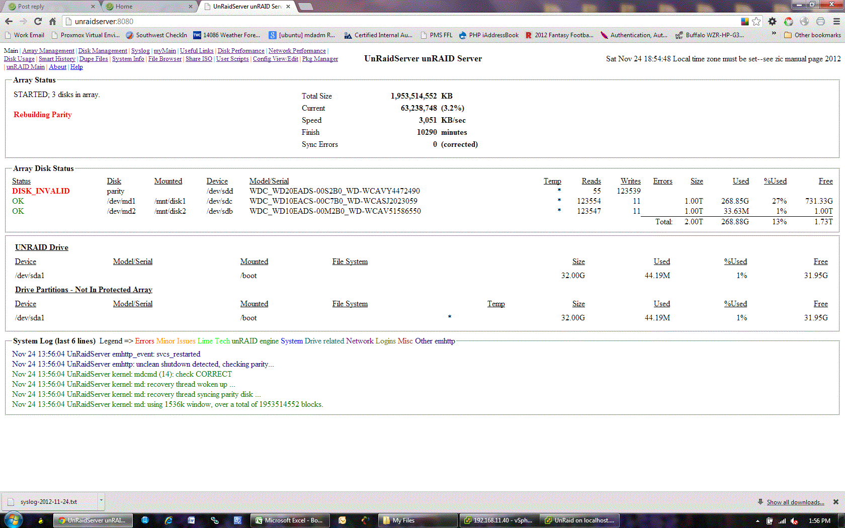

I stopped the data transfer, rebooted, and started just the parity sync earlier this morning, think it was about 10 am.  So its been syncing for about 4 hours now, and I'm at about 3%.    I think I should expect the sync to take a full day?

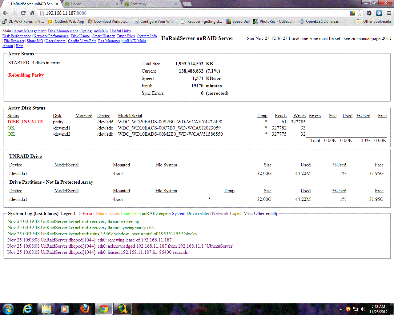

Well, 12 hours later, my parity Rebuild is at 7%.
Is this normal for a 2TB parity drive?  At this rate, it will take a week for the parity sync to complete.

Shutdown the unMenu interface on your Windows computer and don't access your unRAID server using a webbased interface for at least six hours.  The reason for this is that running the interface 'steals' CPU cycles from the parity sync operation and slows it down.  I have observed that 'that a watched pot never boils' effect in all parity rebuilt (or checking) operations.  Watching the progress will significantly slow the process down...
No, you've got a problem unless you're refreshing the web interface 100's of times a second. You should be seeing 60,000-100,000kB/s, not 1500kB/s.

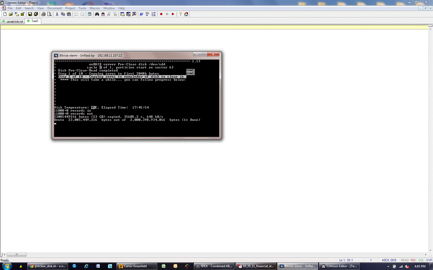

To Summarize.
I've elimimated ESxi from the equation, booting straight to unraid.
The machine has an M1015 card along with a sas expander, and port multipliers.
I am running preclear on only the 2TB drive.  And the machine has 32GB of ram in it.
And Preclear is showing speeds of 648KB/sec.    (attached pic)
Does that seem right to anyone?
