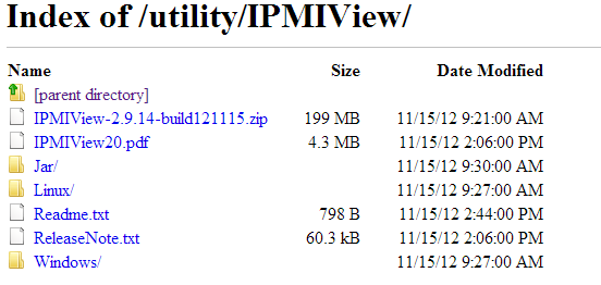

Just FYI, this should work for you : ftp://ftp.supermicro.com/utility/IPMIView/ (I seem to remember it wasn't obvious to find when I originally looked).
Yeah I have an ipmi motherboard also but don't know how to use it. I should look into it
So to use screen I just type in telnet like I usually would then cd /boot, screen, then I hit space bar correct?
The link to IPMIVIEW is asking for a password
Doesn't for me.  I get the FTP directory listing.  You might try again as they also have the PDF manual in the same directory.  It will explain how to use IPMIView.  Once you try IPMI you won't want a remote server without it!
