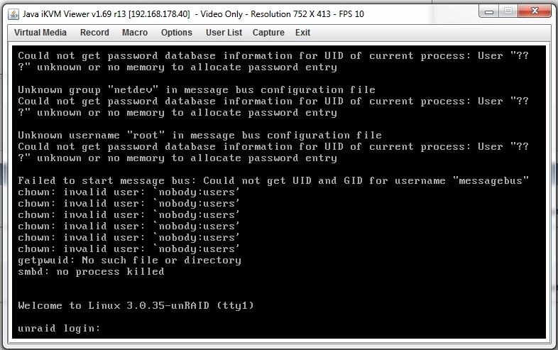

now it seems that I have got another problem, I don't know how I made this.
I made a screenshot, look at the attachment
maybe this is a reason why telnet doesn't get a connection
