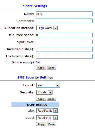

Anyway, im trying to setup user accounts to access folders. I THINK i have all the settings correct and yet when windows asks me to login with username and password (type them in) and says i dont have access. If i make the setting as "Public" then everything works fine. Am i missing something? do i need to mess with some windows setting?
Here you can see i have made two accounts in unraid "guest" and "alex". For the sake of making things simple here, i have made the password "1234". Now i would think that when windows asks for the login and password (which it does) i would just be able to type the account info in and should allow access to the unraid server. The goal being i will make user accounts for computers in the house AND have a guest account so when friends visit they have access to my movies/TV shows.

For unRaid user 'alex' have you entered a password?  If so this is the password you use in the authentication window that pops up.
Best practice for windows users is whatever username/password you use to login to windows you should use for unRaid as well.  For example, suppose your windows login name is "moe", password "astooge".  If you set up that exact same user/password in unRaid then authentication will be seamless.
Also, I notice your 'Included disk(s)' share setting is wrong, if you want that share confined to disks 1 through 4, you enter that as
disk1-4
Could also enter as
disk1,disk2,disk3,disk4

There is a sample attached of one of the shares (all are setup the same - one for Media, one for Music, Photos, etc.)
I can see the shares (and disks) when I browse into \\tower\Media. Everything is good.

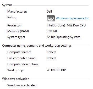

Again, did you check on your Windows machines to see what the workgroup setting was?  (Right-click on Computer, select 'properties' and look under system for Workgroup name.)
Sorry Frank1940, I may not have been precise on my last post.
WORKGROUP is the name of the Workgroup I have setup.
Here is a screen shot from "Computer."

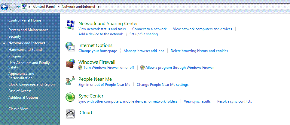

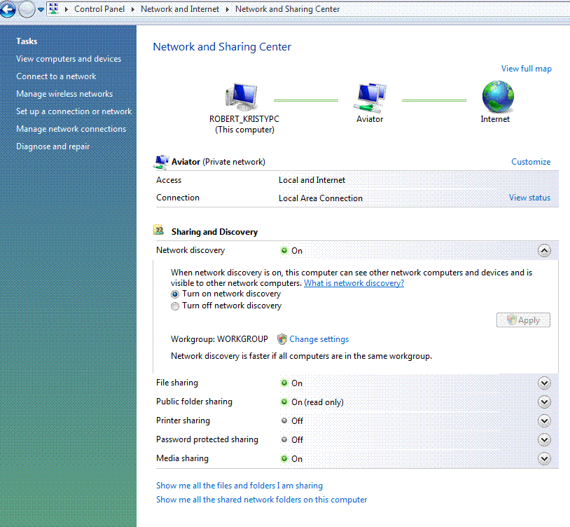

OK ---- Now go to 'Control Panel', 'Network and Sharing Center'.  Now click on 'Advanced sharing settings.  In the Current profile (should be 'Home or Work'), check to see that the following are enabled:
Click on the 'Turn Network Discovery' radio button.
Click on the 'Allow Windows to manage homegroup connections'.

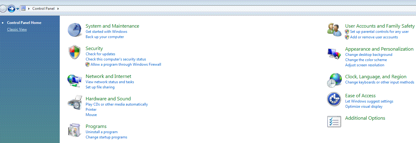

The access seems a little different in Vista. I can make all the necessary changes in Vista with the exception of 'Allow Windows to manage homegroup connections' which I can't seem to locate in Vista.

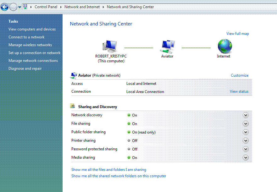

Attached are some screen shots of what I'm seeing in Vista re: getting access to view / change 'Allow Windows to manage homegroup connections.'
I still can't see the unRAID server on any of the devices including the Win 7 devices or Vista device.
Thanks for your help on this - I'm sure it must be frustrating
What is this "Aviator (Private Network)"  that your computer is connected through?  Are all of Windows 7 computers connected to this network?  I have a feeling that somehow you have managed to have your computers connected to a restricted network. Those restrictions could well be preventing your being able to see your server.  On my computer, I do not have an option to customize my network as you do for your Aviator network.
Another question, can you see the other Windows computers on your network from this computer? (They should appear under "Network" in Window Explorer even if you are not sharing anything from them.)
Aviator is the name / profile on the router. All of the devices on my home network are connected to this same router. I hadn't thought of that causing the problem, but perhaps is contributing??
I can see the other other Win 7 devices (two) and my Vista device on etiher the Win 7 boxes and / or the Vista box. have never been able to see the XP devices in the "Network" tab of Windows but have set up folder shares on these in the past with the same Vista / Win 7 boxes.
