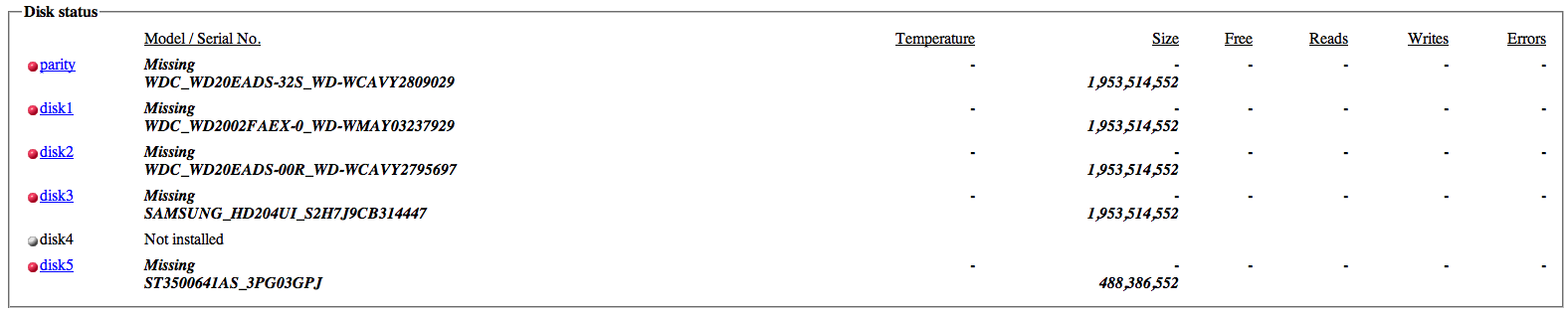

Unraid 4.7. There were some issues with the motherboard of the server so it had to be replaced, together with cpu and memory. Now, with the new MB, after boot, all disks are 'missing'.

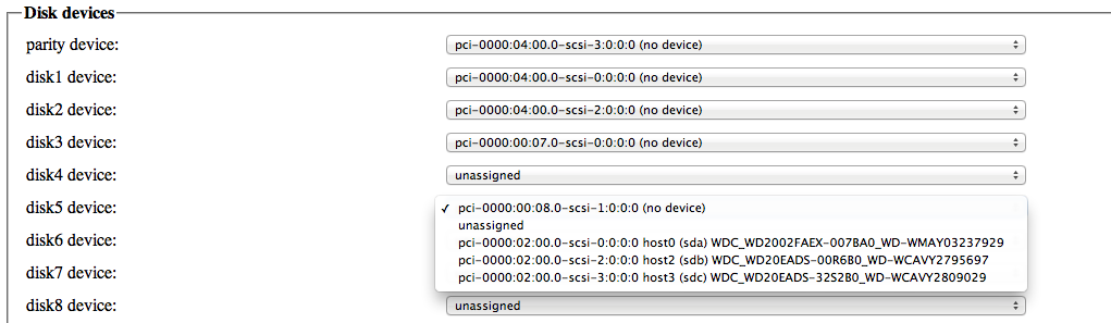

On top of that, when i go to the devices tab, in the drop down menus I see only 3 out of 6 drives. Those 3 that are found are connected on a separate SATA card. The 3 drives connected directly on the MB are not in the drop down menu to assign disks.
In the Bios, the 3 disks on the MB are shown fine.
New MB : Asus P8B75-M LE
Could it be that Unraid 4.7 doesn't support this board? Would an upgrade to 5 fix this? If so, what would be the correct procedure to upgrade and have all the drives recognized without data loss (the 3 drives on the separate SATA card are visible in the devices tab but not assigned as they have a different port number now).
screenshots and syslog attached.
