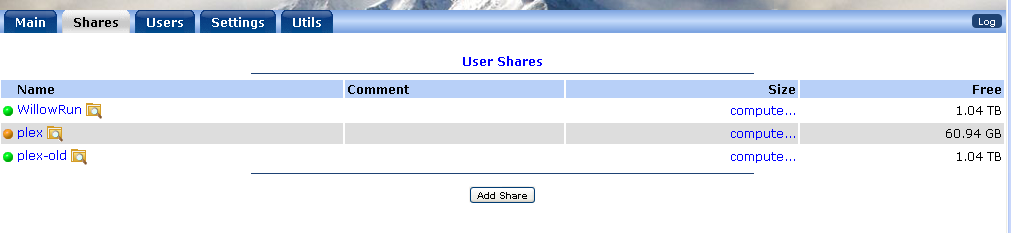

Okay. Did that.
Renamed the PLEX folder (PLEX.Old) on the array so it won't be used but can't delete it from Windows. I'll try deleting via telnet later unless you think this is a bad idea.
The PLEX User Share has yellow dot to its left. I can't find what this means but it's probably not as good as being green. The main user share has a green dot. See attachment.
the yellow dot means, that there is data in this share, that is on the cache drive (and not saved by the parity drive)
since that share is cache only, you will always see a yellow dot there
