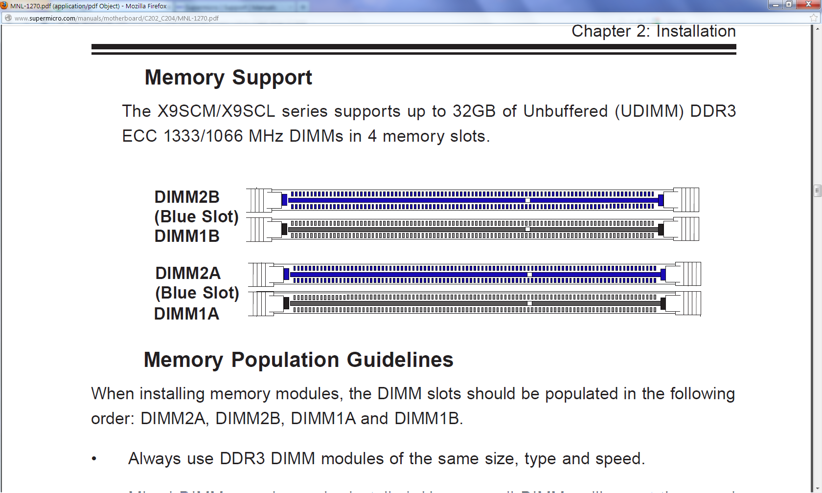

December 11, 201213 yr Is the memory fully seated? When using two memory modules, the recommended setup per the manual is to install the memory in the blue slots
December 11, 201213 yr Author Is the memory fully seated? When using two memory modules, the recommended setup per the manual is to install the memory in the blue slots I actually pulled all the memory off hoping to hear beeps/POST does a led light up on the board indicating there is power ? Yup, the LEDs light up when connected.
